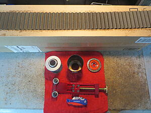

Filter cutter just arrived... I'll post the findings.

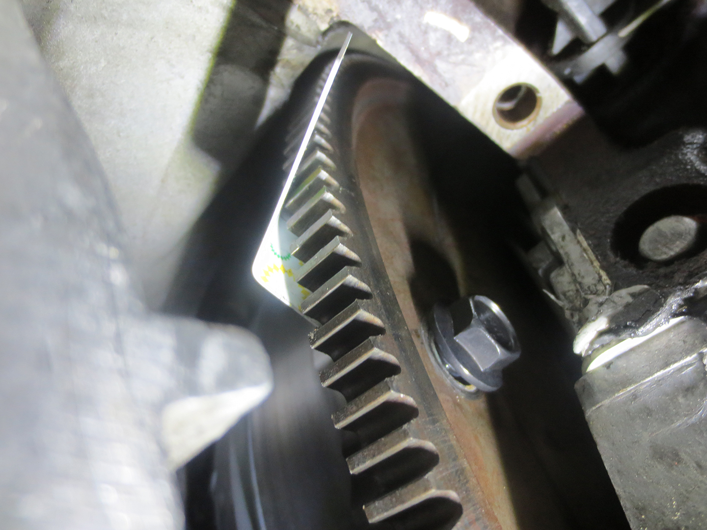

I've inspected the flexplate through the inspection hole best I could and can find no cracks.

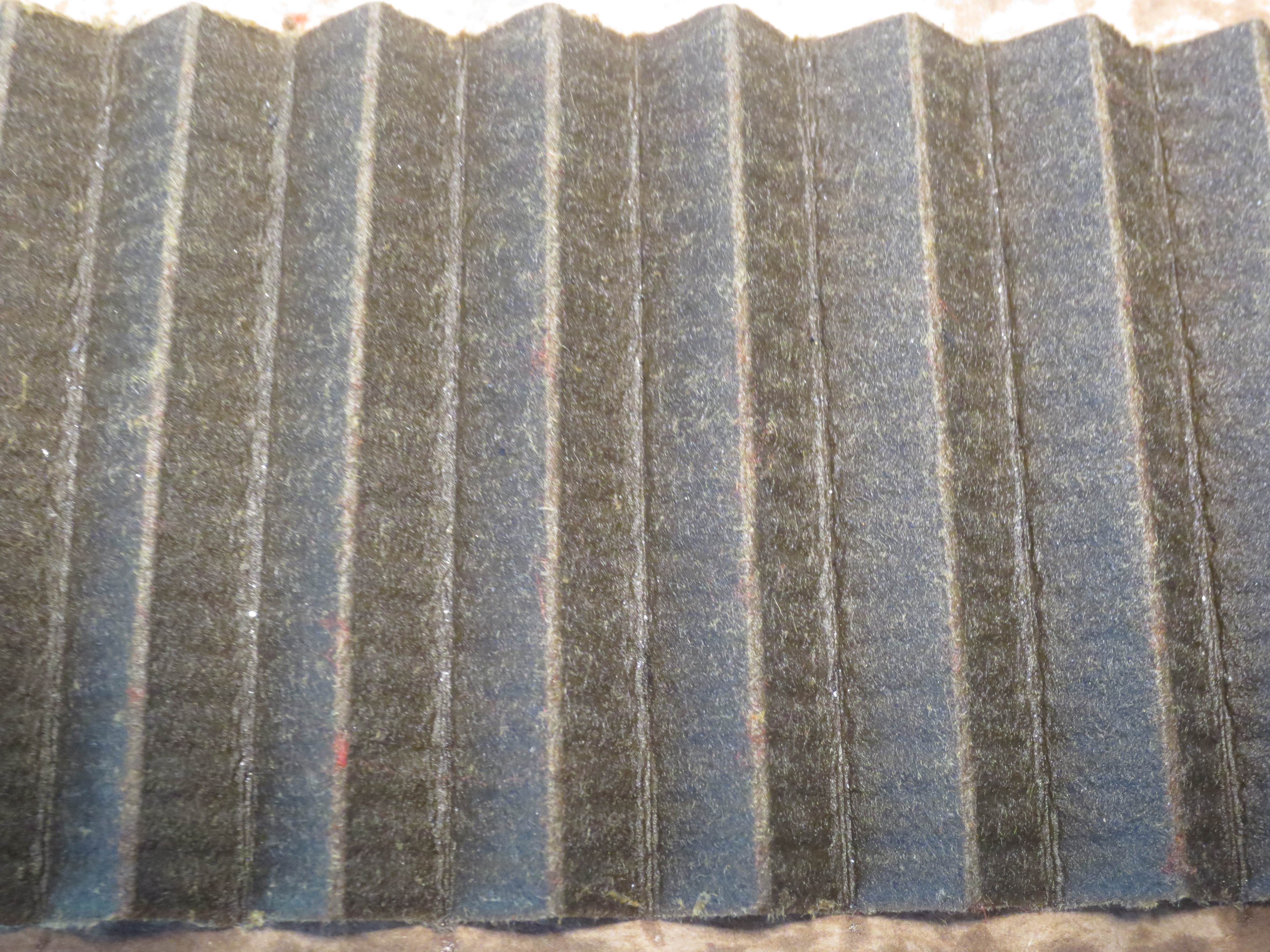

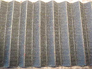

The filter looks pretty clean. I can see an occasional shiny speck I thought was aluminum but dragging a magnate through each pleat the magnate picked up the specks. My guess it's normal camshaft & lifter wear. I'm running dual .660 springs with a fairly aggressive .629" .615" lobe.
