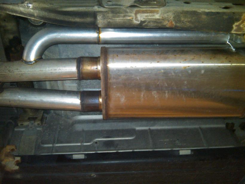

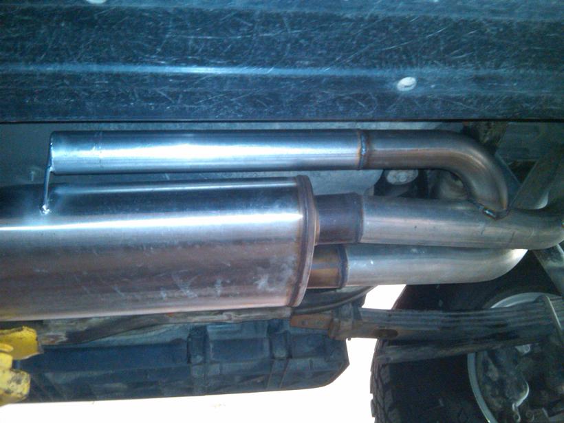

Originally Posted by PoweredByWinchester
This sumbitch drones like crazy starting right at 1600 RPM thru 2000 RPM....which is exactly 55-65 mph. It's not the decibel level that's annoying. It's the tone/pitch. Can/will this possibly go away or at least get better after I put some miles on it????
my setup did EXACTLY the same drone. Dual 3" straightpipes with a Magnaflow 12599 muffler.
I just added these resonators and the drone is 80-90% GONE!
Driver side drone killer:
Passenger side drone killer:
A big thanks to Kyle at KB Racing for getting this done!

I'm glad they worked!! I've put them on both a turbo truck and my Dmax and works awesome! 30" seems to be the magic number for the length of them.
