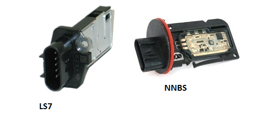

Default ls7mav vs nnbs
I dont think it would fit based on the pix of the mafs
I have not looked at my 08 maf to check on plugging it up. Ill have to take a look.

you have the same style maf as an ls7.

09 and older gmt's had an maf housing, not a slide in card style.

I know, but since mine is a '10, I already have a card style maf. I was just wondering how hard it would be to adapt the ls7 maf into the stock hole...
