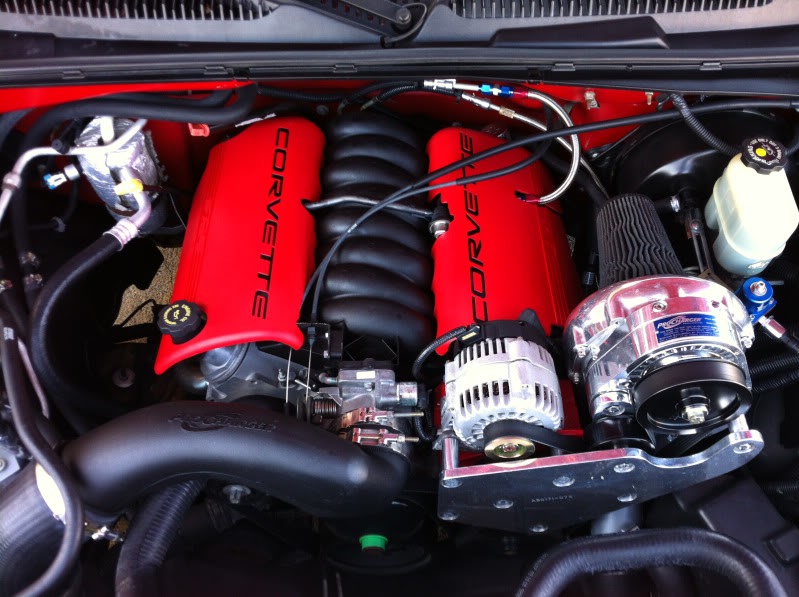

I put a 04 Z06 LS6 in my 99 ecsb. You'll need a Speartech idler pulley relocation bracket about $85.00, I used a water pump for a 07 NNBS think part # 12600767 about $150.00, it cleared my dirve by cable TB and a top raditaor hose off an 07 NNBS part # 19130027 about $52.00. I used the stock fuel rails off a 04 Z06, and an aftermarket fuel pressure regulator with a return line and 42lb car style injectors and installed car style injector plugs in to my wiring harness. Installed a set of Dynatech SuperMaxx #115-841300, 1-7/8" headers. While i had the motor out i pulled my wiring harness out and shortened and lengthened all the connectors so i could route it around the back of the motor much cleaner install. Installed a set of electric fans off an f-body with a nelson wiring harness and relays. I tune with EFI Live i had to change my PCM's operating system to a 2002 operating system, i used PCM 12212156 operating system. If you need any advice are part numbers i have a file full of reciepts and notes, i would be more than happy to share. PM me and i'll give you my number. Good Luck.
Here's a picture with the water pump, fuel rails and injectors installed.
My cam was speced by Patrick G, Guerra Motorsports cam, 224/228 .609"/.588" 110LSA + 2 advanced cam for my LS6
Here' the final Install
Now What it looks like
