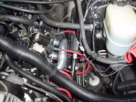

I just cylinders 3 and 5 wires extended by about 6 inches and went around the steering shaft no clearance problems for me

Send me some pics, I was thinking the LS2 with the 90* boot would be easier.

Here they are

Thanks Cody. I will have to get the stuff to make them.

No problem I just got some extra wire form the speed shop I deal with and they reuased the boots and metal clips off the factory length wires. Took all of 10 minutes and I no longer have any problems with it.
