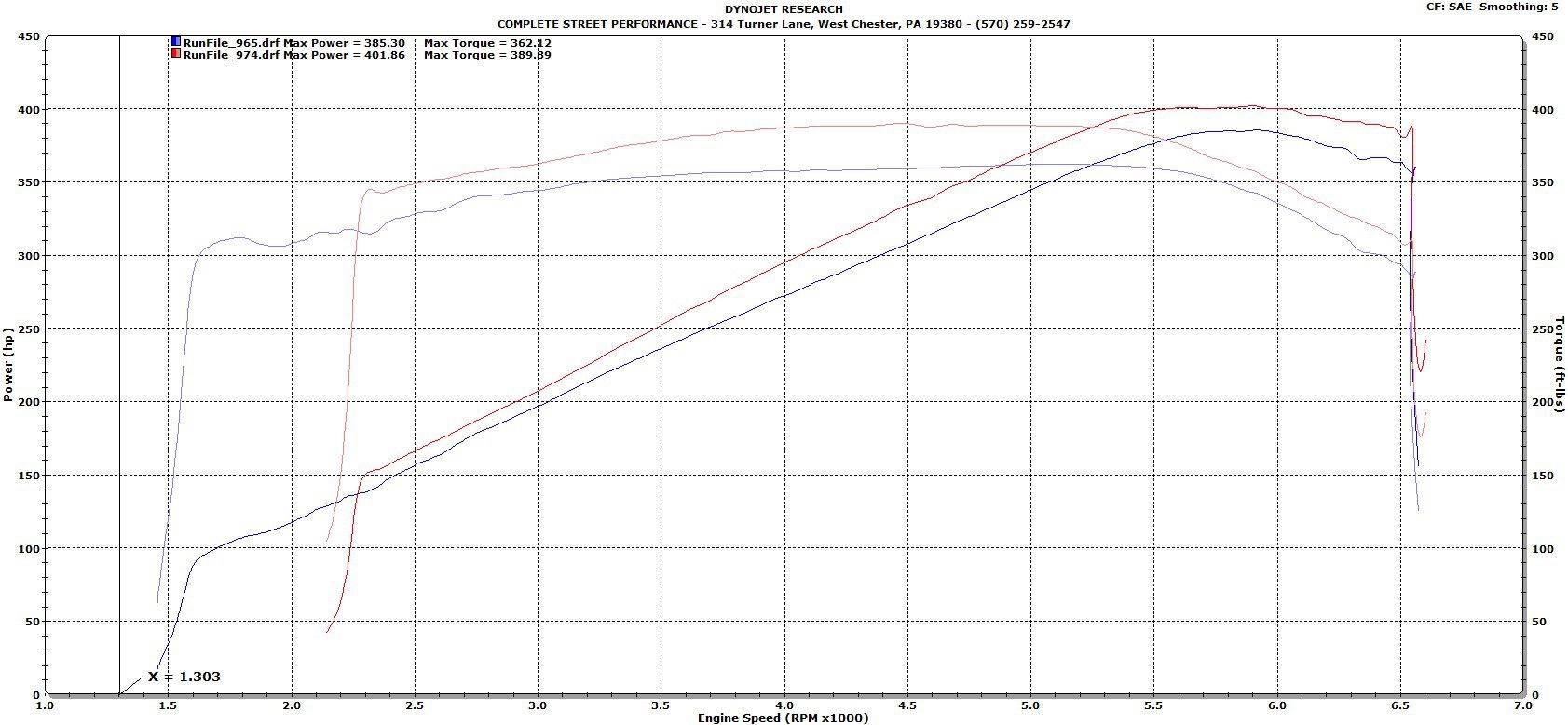

Do you have a dyno graph?
And im guessing that wasnt NA correct?

My trk is a L9H NA. Dyno sheet below. I was off a little
on the RPM range.

If I'm reading that right, the blue cam while making less power had a slightly higher rpm peak, right? The red cam made more power but peaked at what looks like 5600 rpms which is stock shift on my rig. So in essence it brought the power band down some?
On the other end, the beginning of the scale, what does that mean for both cams or pulls? It looks like the red takes longer to make any power but I'll admit I'm not schooled in reading these.

Off by quite a bit on the rpm range it seems.
Are the 2 graphs stock vs cammed? or base tune vs fully tuned?

the blue line was base tune, and the Red
was after he made changes in the tune, it's the
same cam. Tuner just made adj in the VVT
He did the red pull at a little higher rpm.
