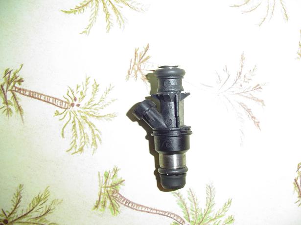

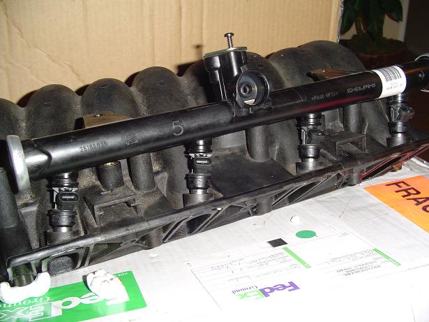

here is a couple pics to chew on

your injectors aren't seated in the intake. the rail is right on the chili. will the injectors just not fit in the intake any further? they will protrude a bit. try taking them back out and try to install only one injector by itself in the intake alone. try a little wd-40 or a SLIGHT bit of silicone lube like dielectric grease for plug wires on the o-ring.

no matter how hard i push,, the lip in the hole is just too small, do your stock injectors fit? give them a try to see what im talkin about

so what you are saying is that the new injectors will not fit past the inside lowermost part of the intake? such as the end of your new injectors are larger in diameter than the stockers? can you post a pic of the two injectors side by side? that would help alot. if the o-ring is indeed up as high as you say it is, they are definately not seated.

TxTerm - He bought the 42 pound Multec II truck injector. Same exact size and dimensions as the stock truck injector. You have a Bosch injector thats is similar in dimensions to the stock LS1 injector (which is why it fits properly in the intake).
Bigguy - if you drilled out that internal ridge, how much more will the injector go into the hole? Will the injector be sticking into the runner if you made this modification? Personally, I'd try it. If its too deep, I'd just add a washer around the injector to space its shoulder away from the intake. I'd also see about getting a thicker O-ring to be certain you have no air leaks.

Also, instead of making a long spacer with a long bolt, you might think about using some 1/8th inch steel and bending your own bracket, then use one bolt on the intake, and a nut/bolt on the rail. This will make it easy to handle the offset bolt hole.

if i drill out the lip, it will slide in about anotehr 1/2 inch. i feel like its worth the shot. and im gonnt use that bent bracket theory and give it a shot.
