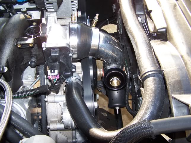

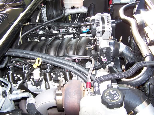

yeah you could use aftermarket rails you would just have to have a crossover on one end, plug one end and have an adapter fitting to the factory quick connect.
here is the best pics of mine with a factory LS1 returnless rail.
