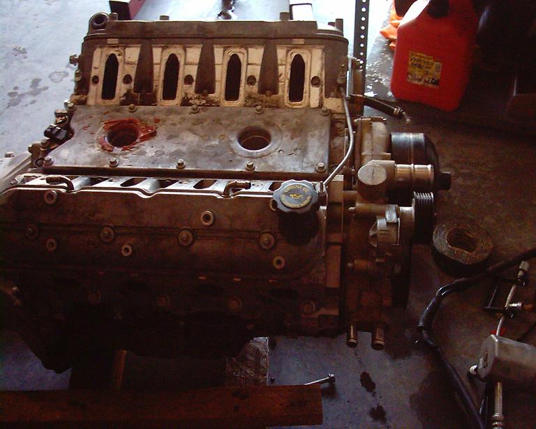

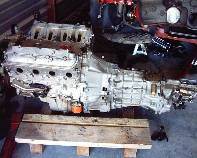

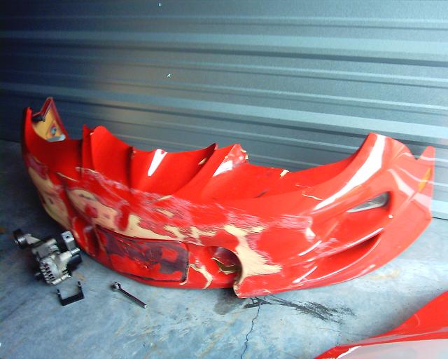

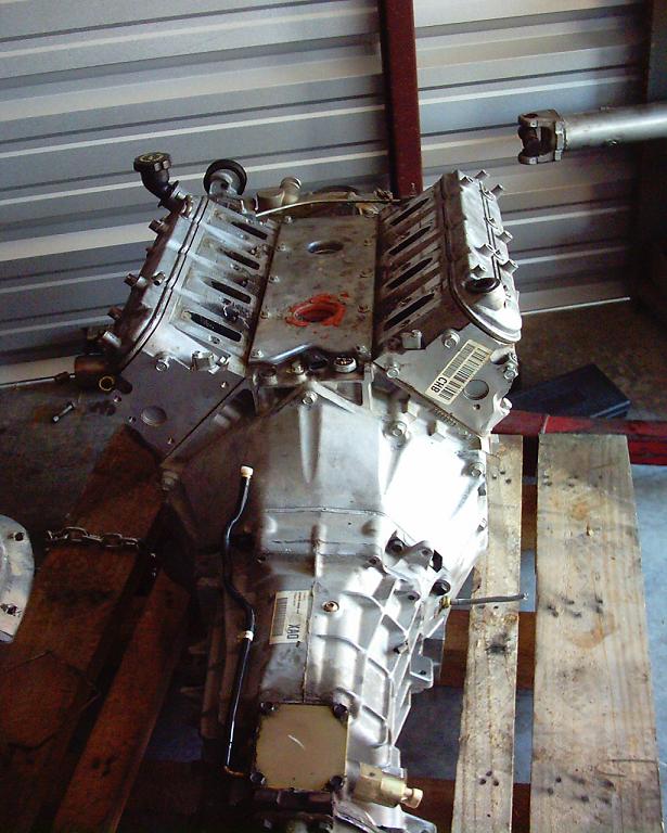

Finally I got the motor and tranny out the car. The only complications were that no one, i mean no one carried the tool that i needed to disconnect the clutch hydro line, so i had to take the ez route out and cut it, sorry. N E ways while the motor is out im going to slap a new set of 1.85 rocker arms, LS6 springs, spec clutch and thats bout it. Any comments or help will be helpful. My only concerns now are the harness and the fuel system.

Old Oct 18, 2004 | 12:06 PM
Mater's Avatar
Joined: Dec 2002
Posts: 546
From: mt.pleasant pa 15666
dam,why u take all that off the motor?
I had to take alot of stuff off b/c since the car is wrecked, all the front end was really pushed back towards the engine. So i needed as much room as possible so most of the accesories had to come off, besides some of them where broken from the crash such as the power steering pump. Hey as far the truck goes, if I use most of the car's fuel system components will I still have to get 97 corvette style fuel rail? And what the heck is VATS and do i really have to get a new wiring harness? Help is apreciate it the sooner I get all the planning straight the sooner I can get this done.
