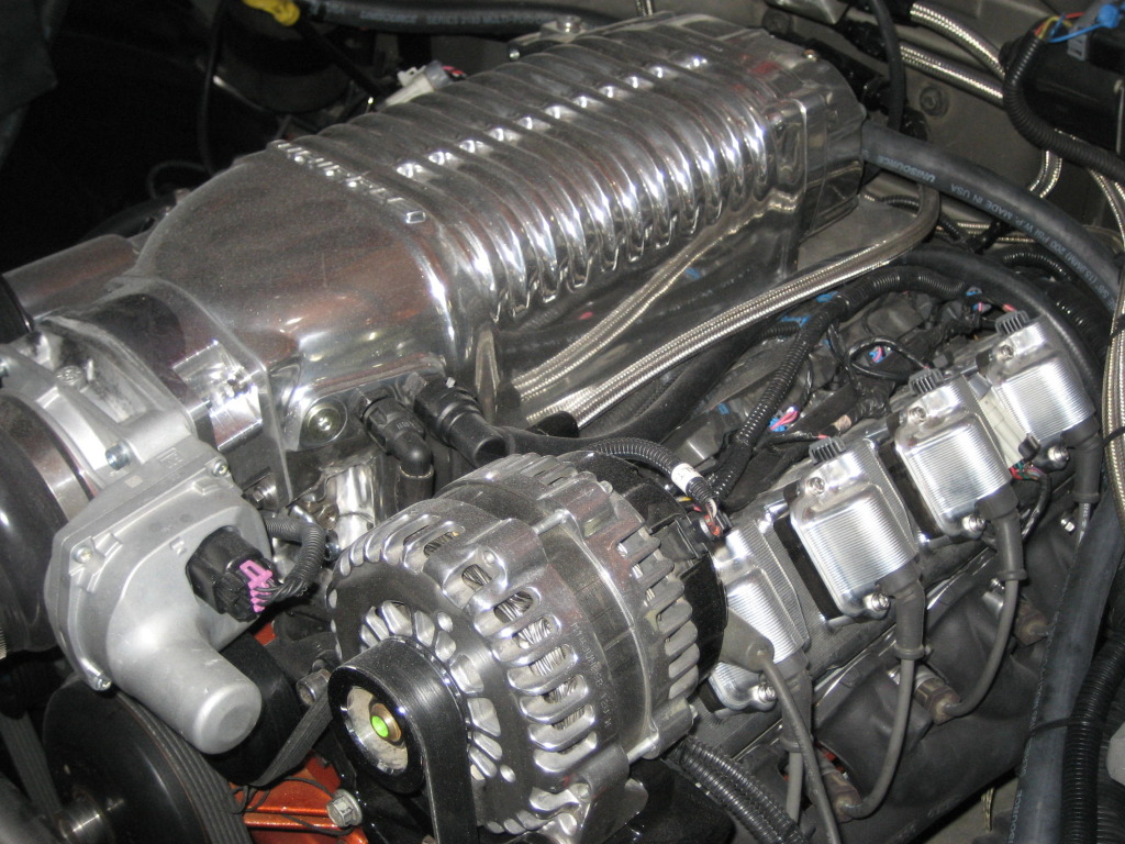

I used the drive by wire out of the donor truck for mine and I had current peformance do my harness super simple ,Can you get a TBSS TB I was told I coul use one if I wanted to use my stock pedalName:  010.jpg
