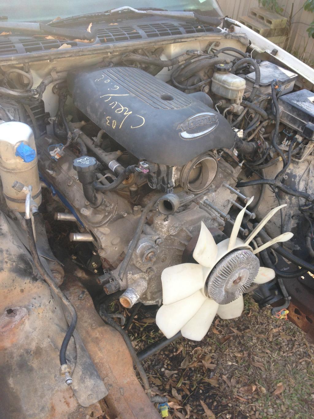

I've added this pic of said s10 and LQ4 don't worry i know it needs to be cleaned up. After i mod everything up then ill take it out to clean, paint and powdercoat...

Is the intake a nnbs with an 87-90mm tb or nbs with 78mm tb? Either way I would save the money and stick with the stock tb and do a diy port on it. You might gain 5hp from a larger throttle body, but you probably wont notice the difference driving around.

Is the intake a nnbs with an 87-90mm tb or nbs with 78mm tb? Either way I would save the money and stick with the stock tb and do a diy port on it. You might gain 5hp from a larger throttle body, but you probably wont notice the difference driving around.[/QUOTE]
Plan on useing a NNBS w/90mm
Old Feb 13, 2015 | 05:22 PM
69Camaro427's Avatar
Joined: Sep 2013
Posts: 660
Yea that's a great intake for a 6.0. It will pick up a solid 10-15rwhp over the nbs that is on it in the pic.
