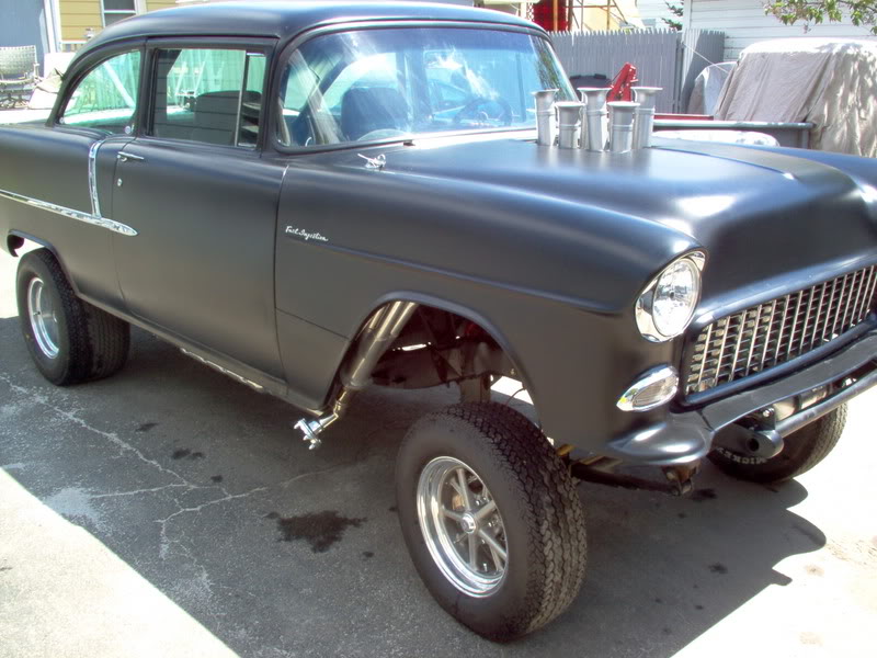

How about the new Edelbrock LSx intake? It looks like a tunnel ram...
I agree, it would look killer! Here's a pic of my 55 gasser
