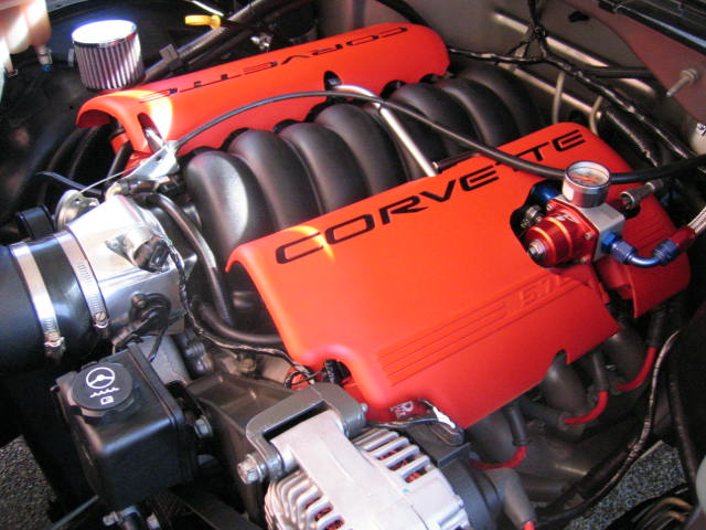

what is need to convert to a L92 set up besides the L92 heads and L92 truck intake and 90mm Cable driven throttle body.
Cant find much good info on this if anyone could help this would be great.
FYI/ this is for a new motor (408-427) i will be building for my 02 silverado

need the fuel rail or modified one.
need bracket for your cables
its just like any other head/intake swap

I used a aftermarket fuel pressure regulator for my return style fuel system and my bracket came with my Holley 90mm. I used the L76 intake.Looking for info on L92 setup with cable driven TB-truck-009.jpg
