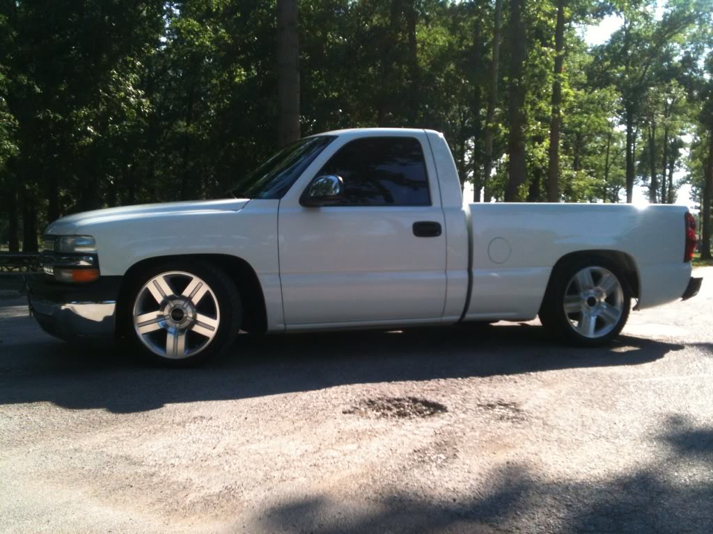

Ok I have 2000 rcsb silverado 5.3 2wd and I have it at a 4/6 drop, would long tube texas speed headers work? Or will they scrape? If they scrape what's my next best header option? I wanna do true dual slp loudmouths with a x pipe, but not sure if I should use 2.5 inch pipe or 3 inch pipe, and what to do about where to make my cuts to make true duals, any info is much appreciated thanks!! Here's a pic to show how my truck sits

That thing sits amazing. Beautiful!

Thank you lol it's pretty much shaping up into my dream truck, it's a forever truck for sure
