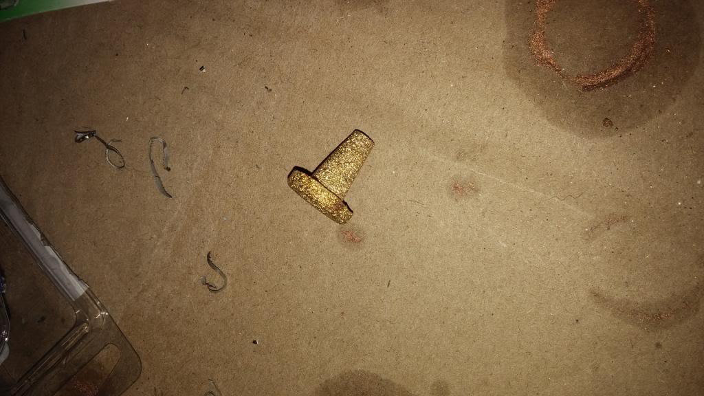

I bought the short and long length defoulers to experiment. Drill out the short defouler with 1/2 drill bit and use a Dremel to make the 02 sensor fit down inside.
Then take the fuel filter and remove the outer portion so that you only have the cone and base of it.
Place it in the longer undrilled defouler and add washers to secure it. Stack the drilled defouler with the 02 sensor installed and install it in the down stream 02 bung.
I have catted long tubes so if you don't have cats then you may need to use two long defoulers to pull it further from the exhaust flow.
