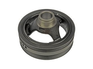

Guys, I need some input on how to get this balancer off my 6.2 for a cam change. I bought the Chrysler balancer tool (OTC 6667) and it doesn't appear that its usable on this one due to the lack of the tabs on the snout. Should I just look for a 3 jaw puller? And where do I hook it up? Here is a picture for reference and thanks for the help!

The tabs are on the back side, you will see three ledges so to speak that the puller can grab.

This is always a pain in the ***... but as Pat said the tabs/flat spots are on the back of the center.
If you have to get a 3 jaw puller make sure you get the 5 ton.

Start by removing that bolt......
As the others here have already mentioned, there are recesses (grooves) on the backside of the pulley for the tool to grab. Stick your fingers back there and you'll find them.

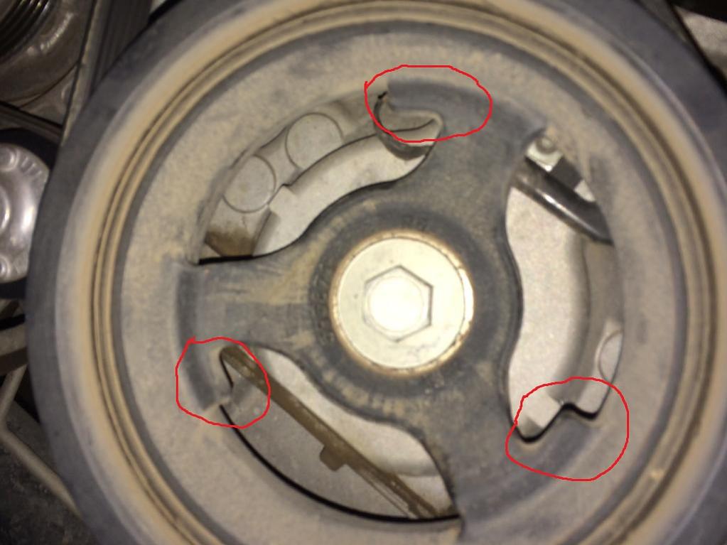

Attach your remover to the tabs circled in red. Cheers!

Originally Posted by Flyin 1500
Attachment 69254
No. Wrong. Sorry.

You can see one of the places for the puller in this pic. Do not pull on it from the outer edge like shown above.

Originally Posted by AKlowriderZ71
No. Wrong. Sorry.
worked for me.
