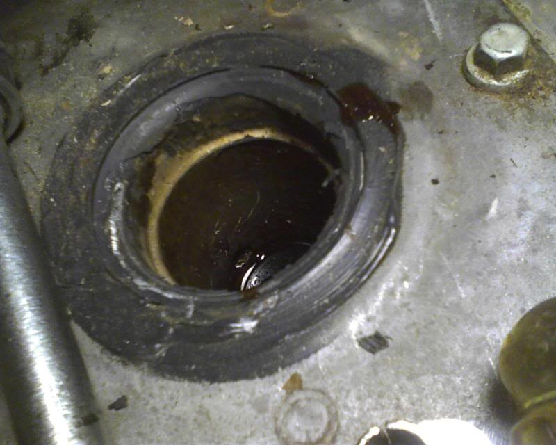

no the sensor is out! just the threaded part of the sensor broke off flush into the threaded hole. so ill be able to get the cover off, just have to find a way to get the part that broke off out of the threads... wonder if some easy outs will work? got a brand new set i havent used yet... but also, why the hell is there a hole in the valley cover? let me go see if i can snap a pic right quick!

The only way I can see a hole being in the valley cover is if the rubber grommet that holds oil in and that the sensor sits in, is fucked up. Which is very possible

can you see the hole??? the hole is on the backside of the "hole", kinda off to the left a little bit. wtf is it for? you can see all the oil in the bottom from the hole

and here is where the sensor broke off!

looks like a hole in the valley cover letting oil in. get a new valley cover.

Under the sensor there is a stiff rubber grommet that the sensor sits in, it is built onthe valley cover, although they can be replaced if need be. Pull the valley cover off and inspect the grommet. There should be only one hole, the hole that the sensors goes thru to screw in the block
Edit: is the hole in metal or rubber? I cant tell
