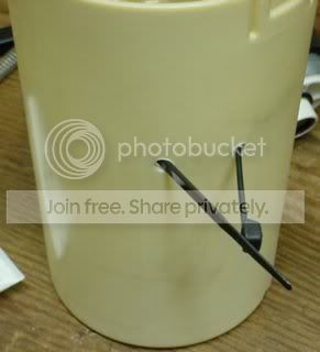

12.The bucket will have to be modified at the bottom so the pump inlet will go through the bottom far enough to install the filter sock. (I used a dremel tool) see pic #1 below.

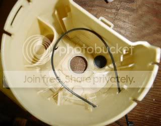

13.Then I had to modify the bucket so i could secure the pump. See pics 2 & 3 below.
