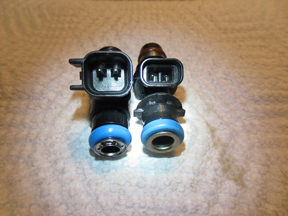

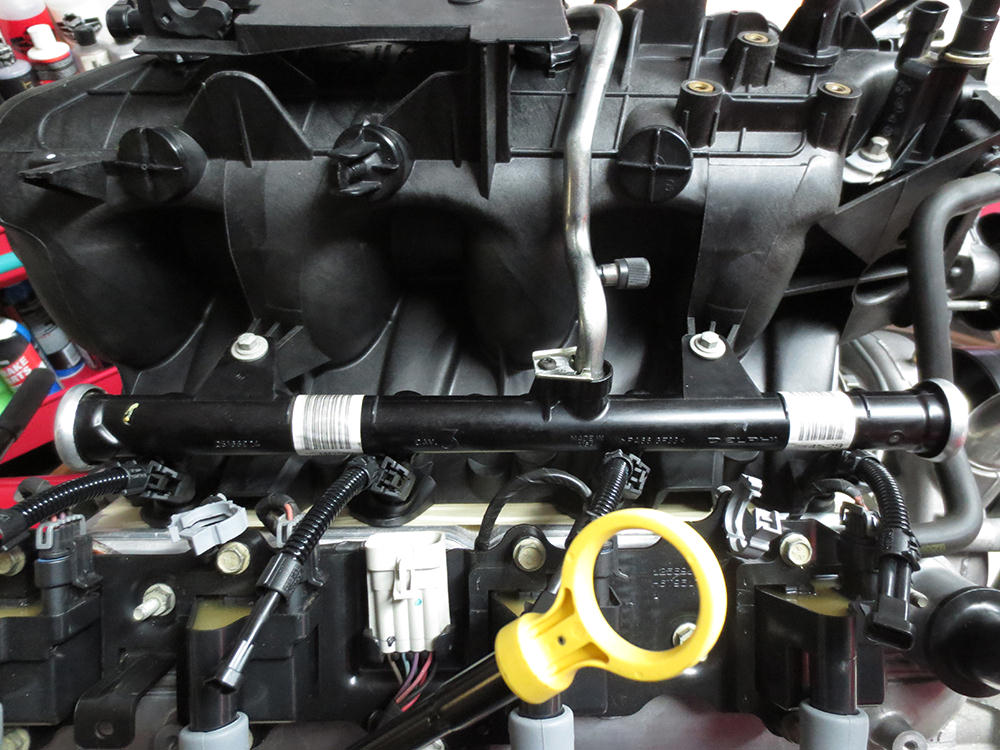

It appears i ordered the wrong injector adapters for my tbss/injector swap i ordered the EV1 to EV6 thinking that's what i had when it looks like i actually have the mini delphi/Multec?? Just wanting verification so i order the right stuff this time.
factory LQ4 injector
EV1 adapter on left, plug from truck harness on right
injector on tbss manifold
https://fuelinjectorconnection.com/c...to-ev6-adapter
this is a link i found to what im pretty sure is the right adapter for my application, anyone have a link to a quality set for a good price?? prefer not to cut my factory harness

You are correct Delphi to EV6... I bought my set off e-bay for my 2005 LQ9 when I upgraded to (50 lb/hr) 2010 Flex Injectors, working fine so far. I wish there was an adapter without the wires connected, kinda messy looking IMO.
