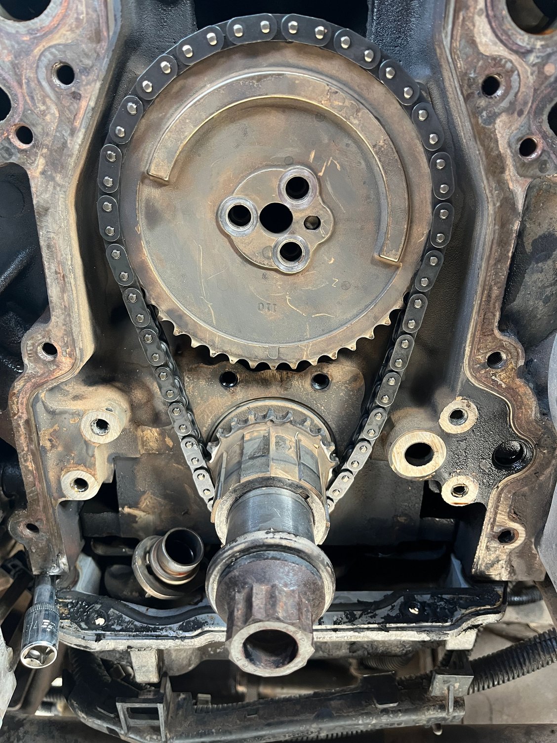

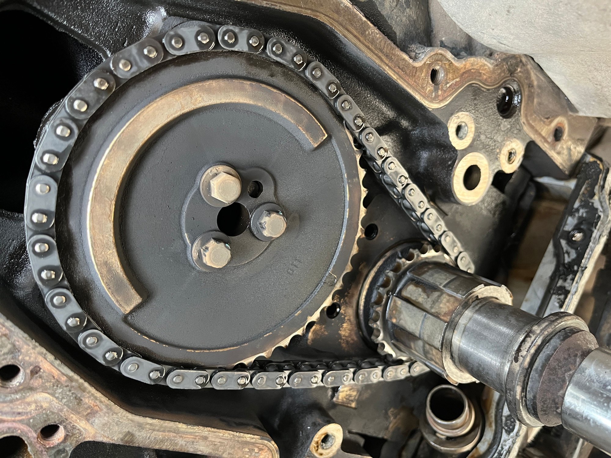

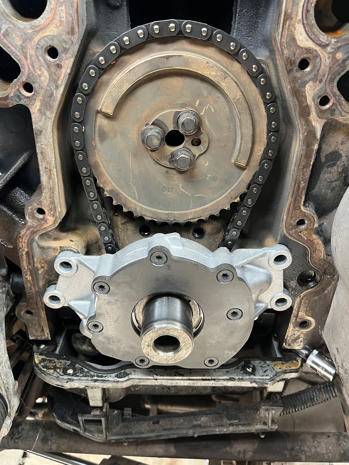

So around 60k miles ago, I had a lifter collapsing, and it started to eat a cam lobe. I pulled the cam, lifters, push rods, valve springs, rockers, oil pump, and timing set. I replaced them all. From the get go I was really disappointed in the cam (compared to my first cam I installed). It was a torque monster down low, but it signed off at 5500 rpm’s. My oil pressure was good, but I just felt like it didn’t make the power it should have. Recently my oil pressure started getting weird at high rpms, and fell to 20 psi at hot idle. I pulled the front off the engine to replace the oil pump, oil pickup tube oring, and the cam retainer plate. I found that I had installed my cam one tooth off!!!! I corrected the cam timing, replaced the oring, retainer plate, and put a new oil pump in. My hot idle oil pressure is at 40 psi now, and climbs to 80 psi at 6200 rpm. My truck runs great again. It pulls hard all the way to 6200 rpm, and just runs better. I can’t believe I screwed that up so bad. I’m lucky that I didn’t hurt anything. Lesson learned.

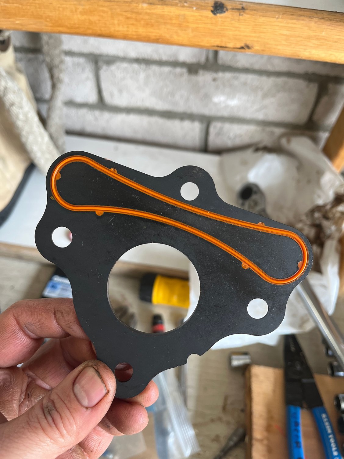

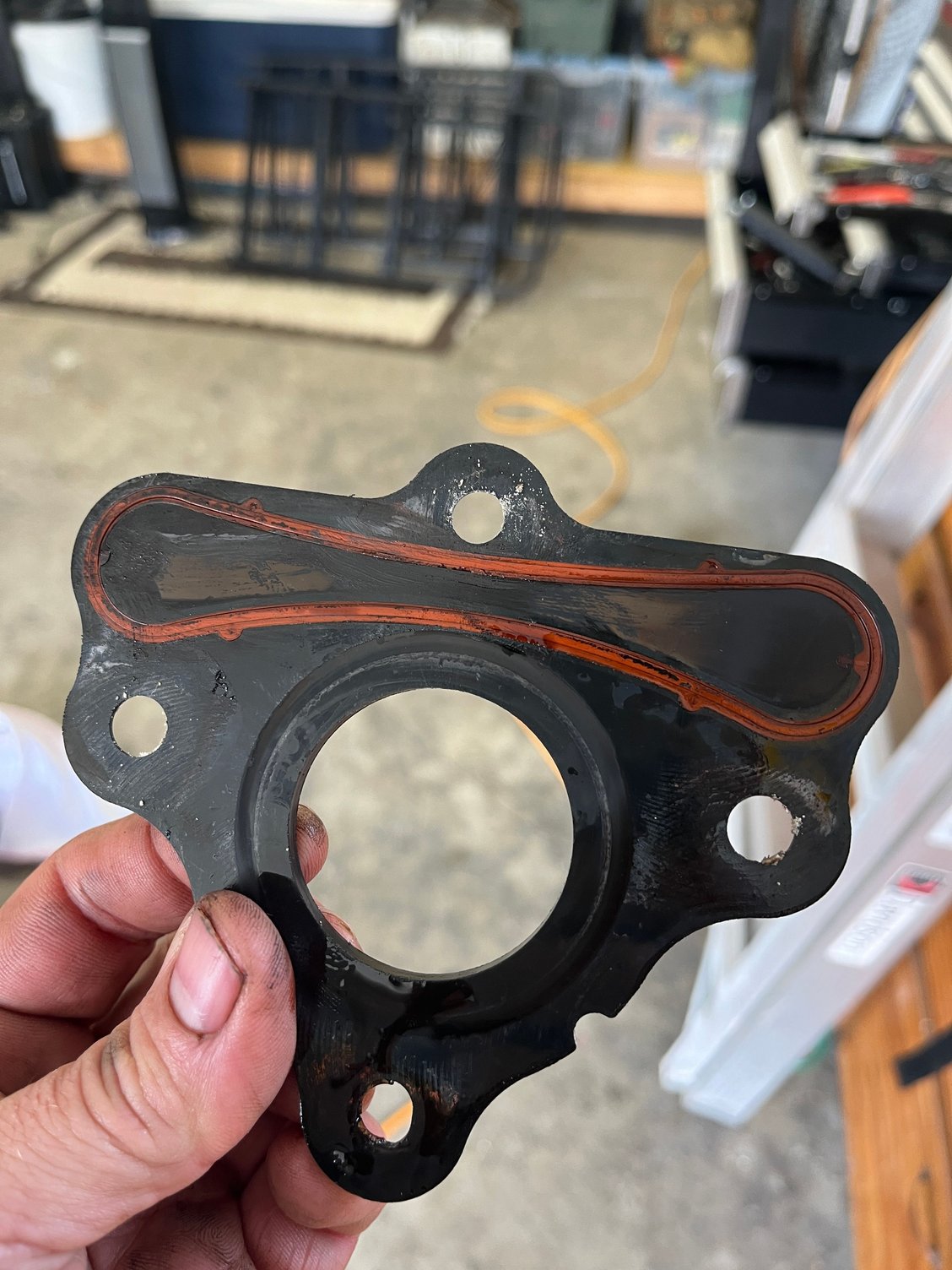

Oil pressure was good up until a month ago. I went in, just to resolve the oil pressure issue. I was lucky I did, because I wouldn’t have known that my cam was off a tooth. The oring actually looked great, the oil pump didn’t look bad either, but the oring on the cam retainer plate looked bad. I never replaced the retainer plate on the first cam I did, or the replacement cam I put in. So I’m 99% sure that was my problem. Put the melling 18% more volume pump in this time around.
