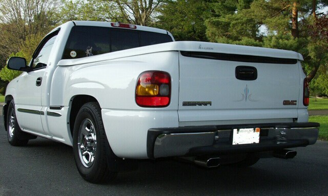

I run one of those larger "straight thru" Magnaflows on my '01. The place that did my exhaust told me it was the "quietest" loud muffler they had. Sounds nice and no in cab noise.
Run a Gibson on my 98 GMC and it is pretty mellow with no cab noise either.
