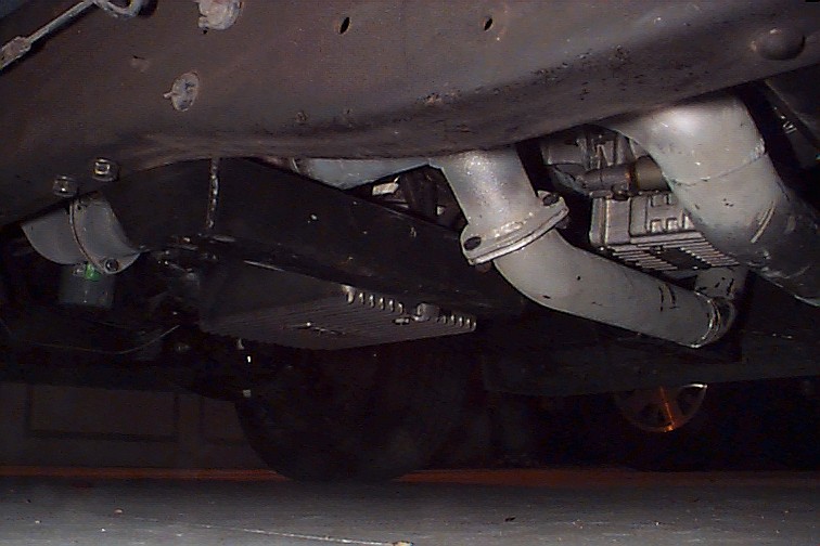

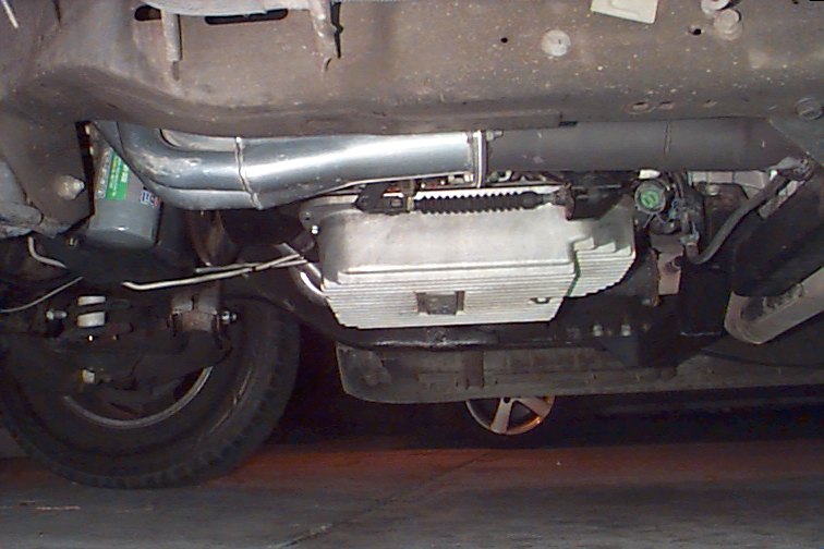

Also,James,do yo have cats on that thing man?Am i reading right that you have 4 magnaflow 3 inch mufflers???That thing sounds badass man,I am curious on your exhaust setup except for the headers?
If memory serves me correct and James...correct me if I am wrong but he does have 4 mufflers. He has cats mounted to 3" pipe running to 2-Magnaflow oval mufflers and out the back with resonator 4" round Magnaflow mufflers and then turndowns I do believe. I don't know about the X-pipe though....it does sound good for sure.

There are no catalytic converters on it right now. It's loud and stinks. I want to fix it as soon as Magnaflow's short-bodied Metallic units become available to normal people.
It does have four mufflers with turndowns forward of the rear bumper, each side. There is a 2.5" balance pipe just after the rear O2 sensors. All other pipe is mandrel-bent sections chopped and butt-welded together.
Here are some links to pictures:
http://bertok.us/pics/HSC-Installed4.jpg
http://bertok.us/pics/exhaust/midsection2.jpg
http://bertok.us/pics/exhaust/balance-drvr.jpg
http://bertok.us/pics/exhaust/feb2005-2.jpg
http://bertok.us/pics/exhaust/bends.jpg
http://bertok.us/pics/exhaust/groundlevel.jpg
I crossed the right and left in the back to try to equalize overall length of each bank. It seems to work, exhaust inside sounds very evenly pulsed.
