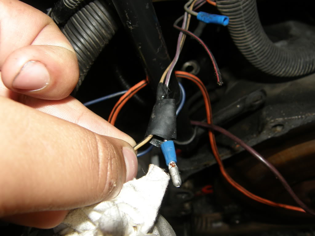

1.Find the plug that used to plug into the Distributor and lead to the PCM.
2.Find the Purple/White wire
3. Take Wire and run it into the TACH position on your HEI Distributor.
4. Done!
Picture of wire with a quick disconnect.
4. Done!
