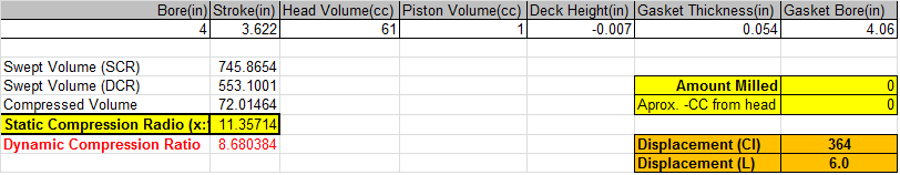

Using the info from first post and my calculator here is what I get assuming 1cc for the flycut pistons...
Attached Thumbnails help determine DCR & fuel needs of my build-stucompcalc.png

perfect combo IMO
