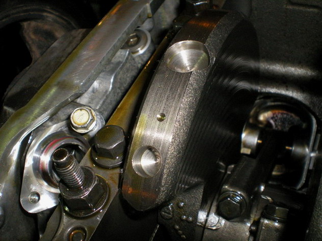

Heres a picture of the counterweight balance drillings on my 03' LR4 Vortec 4800 out of my truck, correct me if i might be wrong, but those wouldn't be there unless it was dynamically spun and balanced with slung weight attached to the crank, would they?
My question is, do they batch together piston/rod assemblies according to closest weights, modify the slung weight on the balancer and install from there? Or are things far less technical than i think?
I'm not sure about any "dynamic spin balancing" to my knowledge GM only did that on the syclone engines, supposedly (not sure of that, just what I heard)
all truck cranks are cast, forged, and machined (including drilling) to a given standard. meaning they drill the counter weights to mimic what they try to make every rod and piston assembly weigh.
the only control over rod weight is the mold that the molten powdered metal is poured in to, then hammered on, in a given set of dies. the big and small ends are machined accordingly, not to weight, but the size specs.
GM figures that their quality control is good enough to mass produce 10's of thousands of cranks each year, all of which are drilled to compensate for the weight of any of the 100-some odd thousand rods that are hammered in to existance in a production year.
the crank in your 4.8 has seen no different treatment concerning balance, than any other 4.8 built in '04. 5.3's would be different, given the larger (heavier) piston being used, but that's about all that's compensated for.
it would cost WAY to damn much money to dynamically balance every truck motor before installation. think of all the extra labor and machine work involved, when they can charge just as much, and not do it.

Yea, that was more or less what i was thinking, a somewhat "generic weight" that all cranks are balanced to. Have you ever weighed a set of rod/piston sets to see what they are like?
I have absolutely no idea. lol
I do machine work for a living, but have never machined an engine block before.

yea, would be interesting to know anyway, obviously gm's process is accurate enough to allow these motors to spin to 6000rpms + smoothly. You know an engine is pretty well balanced if you can set a glass of water on it, and it hardly ripples. Might have to pull them all out since its upside down right now and find out!
