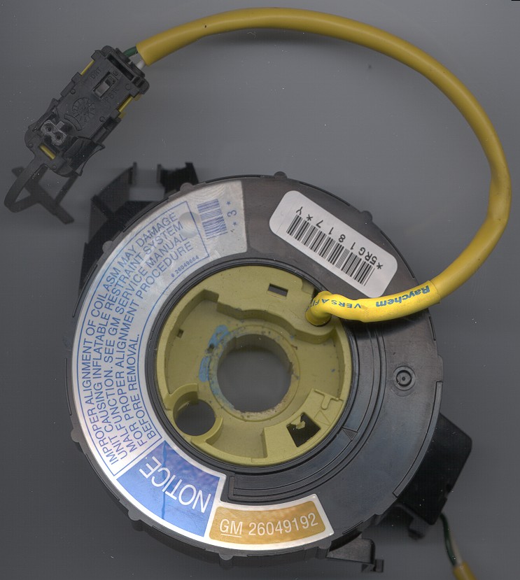

The part you are looking for looks similar to this, but with more conductors. It's called a "SIR coil".
(Do not use the part number from this one - it is totally wrong for your truck.)
