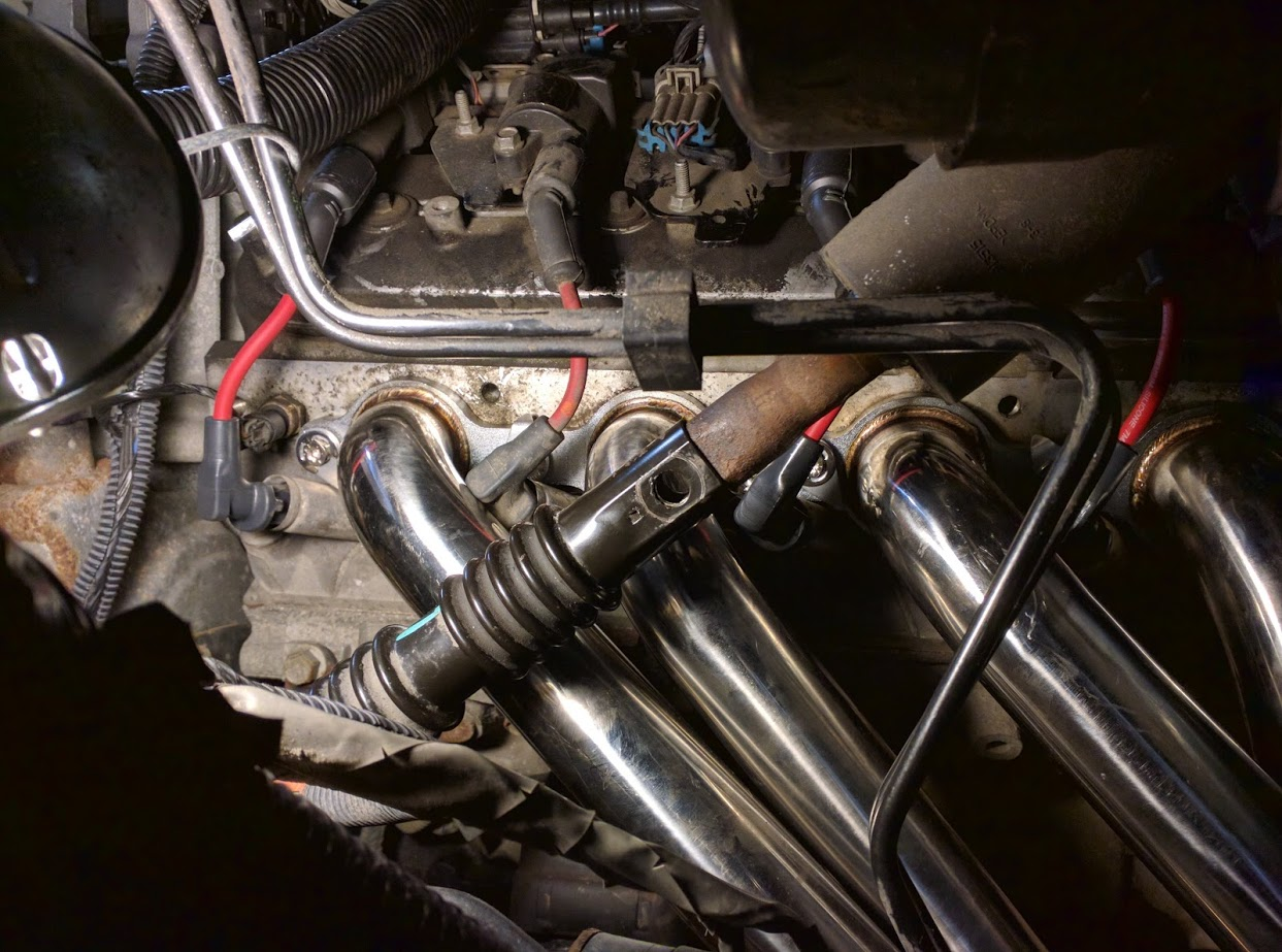

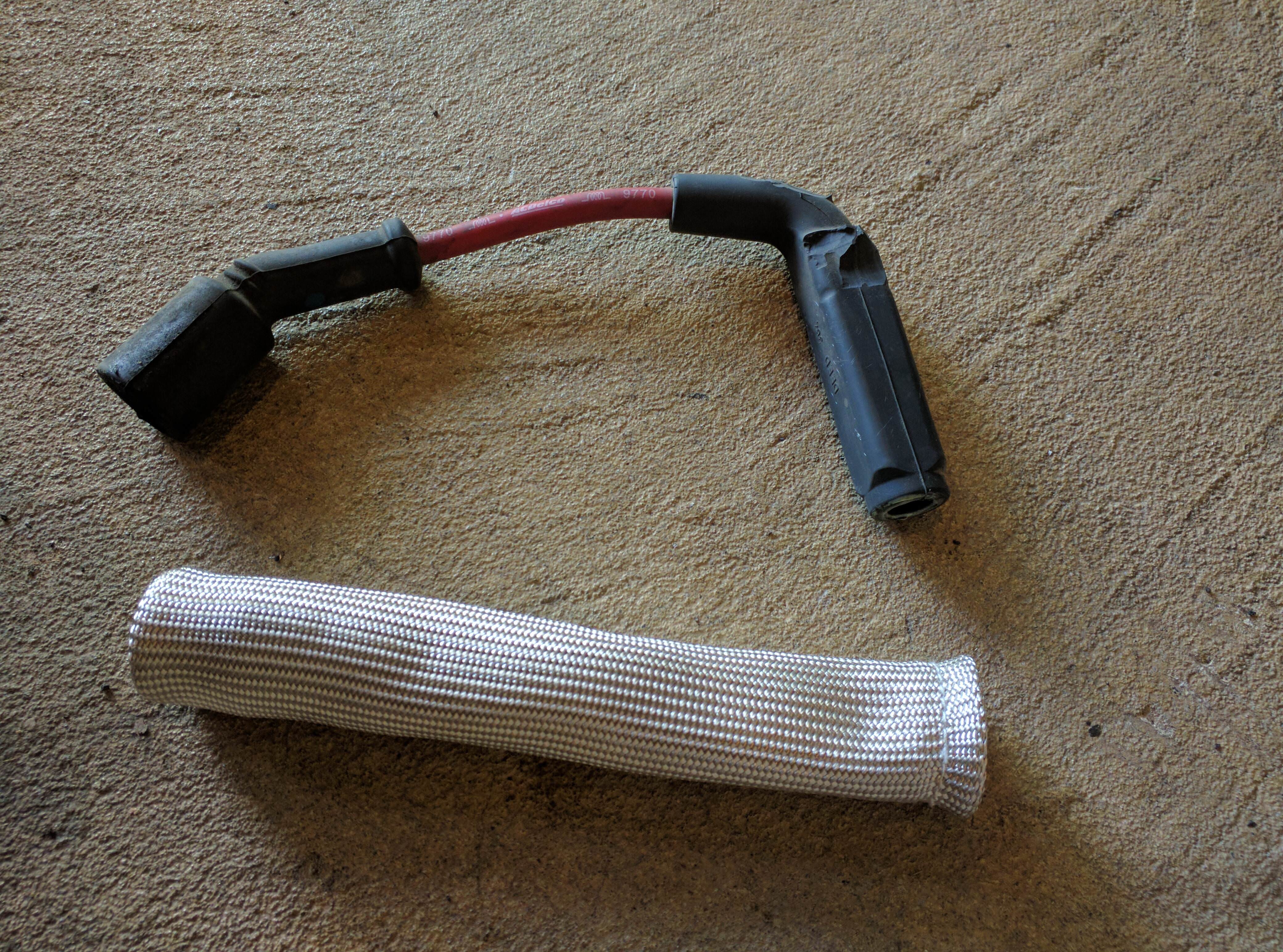

I have the same headers.
I'll get MSD wires later but a plug shaving, thermal cover, and a zip tie to pull things out of the way worked for me.
Offending plug

Trimmed & Cover

I don't mean to point out the obvious... but your missing the bolt in your steering shaft
Also by the looks of it that spark plug boot was covered in oil. It has to be coming from above the boot. i would be looking at the valve covers.
