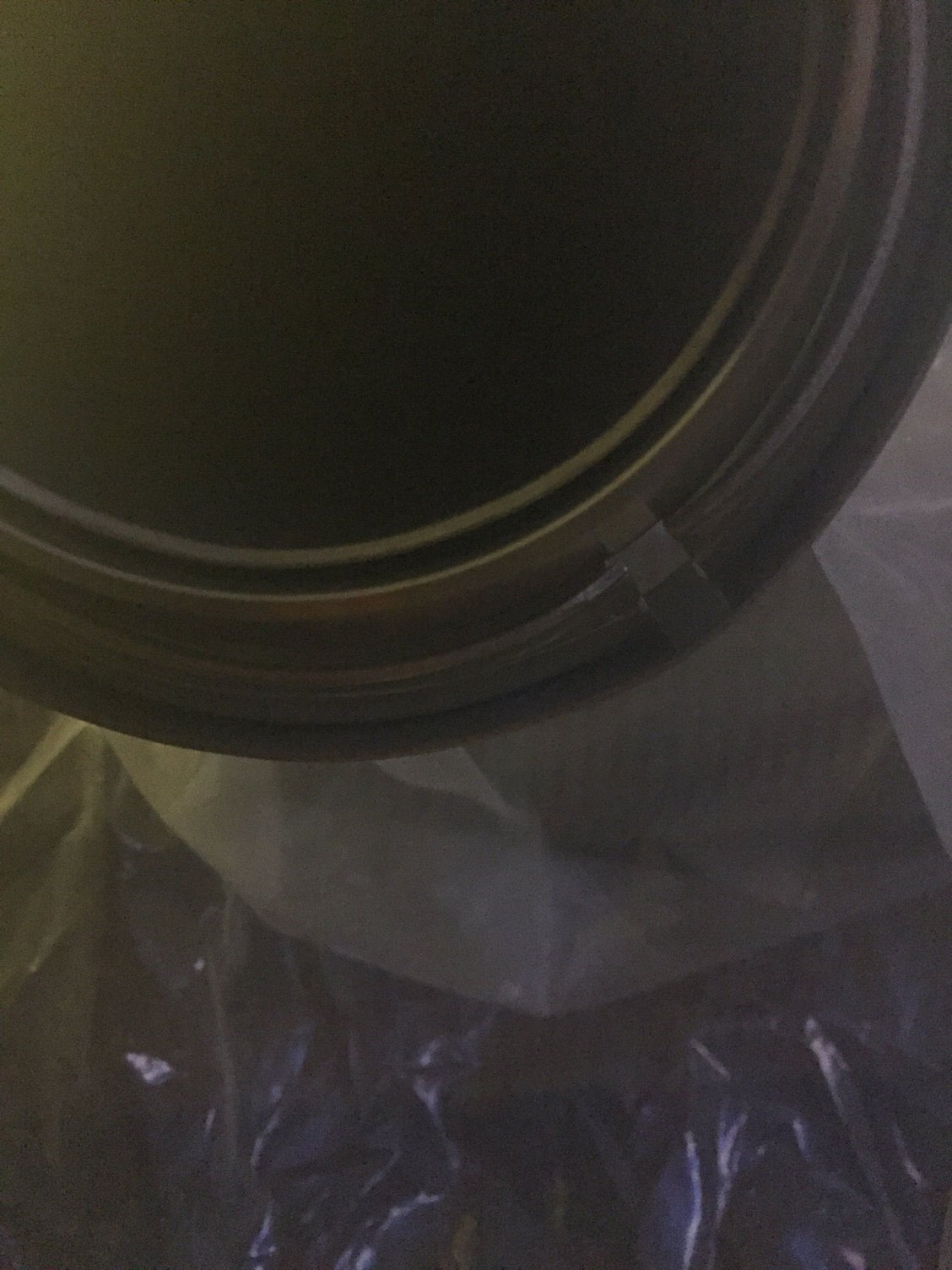

Use heavy duty aluminum foil folded up as a gasket. Works great for a exhaust gasket.

And wide band clamps, been talked about on their thread about the headers, the included clamps suck!!!! Go to local parts store and grab a couple.. And it should seal it up along with aluminum foil trick!!

This is pic of my v band slid over the end of my collector.. Notice the gap!! Its only that bad on one side.... Sticking a pipe expander in the end of the collector would most likely cure this but may explain the leaking issue..... Especially if y pipe expansions are as out of round as my collectors are.... Be willing to bet if youd run a pipe expander in both sides of the slip joints, you wouldnt be dealing with leaks....
