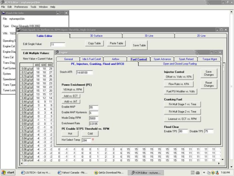

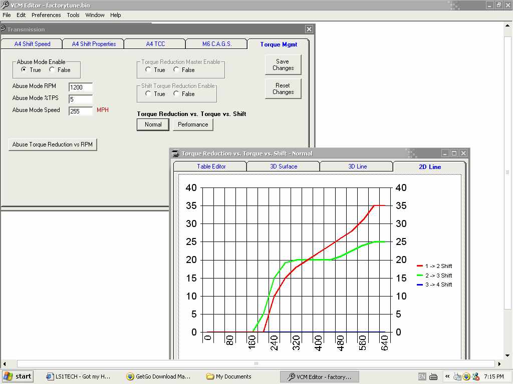

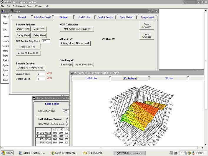

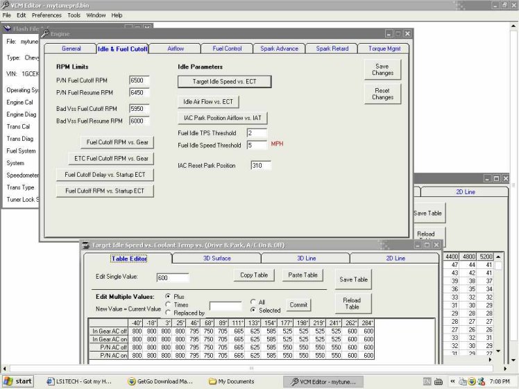

Originally Posted by Black02Z71
I finally got to play with HPtuners today, I was up north at the cottage this weekend getting eaten alive by black flies.
HPtuners rocks, I can read the pcm in less than 2 min, and write in 27 sec. The scanner that comes with it is pretty basic, but they are working on adding to it, like there is a pcm control button on the scanner, if you click on it, it says feature not yet implemented, so there working on it. HPtuners can only get better.
What I have adjusted so far. Working off Predator tune
RPM limit
shift points
raised idle speed
Low and High octane table (Copyed high table to low -2)
added 2 degrees across high table
- LTFT (scaled IFR vs kpa using spead sheet)
tuning_1.0.2.xls
- PE table (X93%)
knock learn min rpm 7000
abuse mode 7000rpm
disabled ses on PO300
HPtuners forum

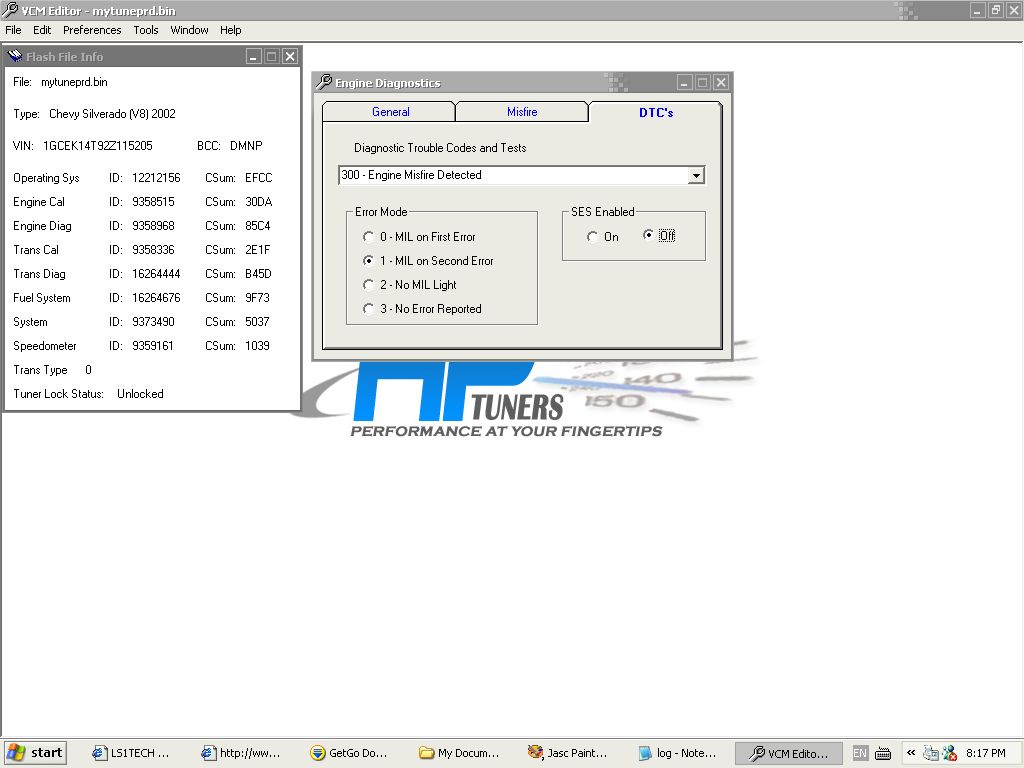

How did you delete the PO 300 code. I have this same code becuase of the cam and would like to get rid of it. I just don't want to compretely get rid of to where even if there was a dead on misfire (i.e. plug pulled out) it would not turn on the SES or throw the PO 300 again.
Old May 24, 2004 | 06:49 PM
  #22
Black02Z71's Avatar
Joined: Mar 2004
Posts: 361
From: Ontario, Canada

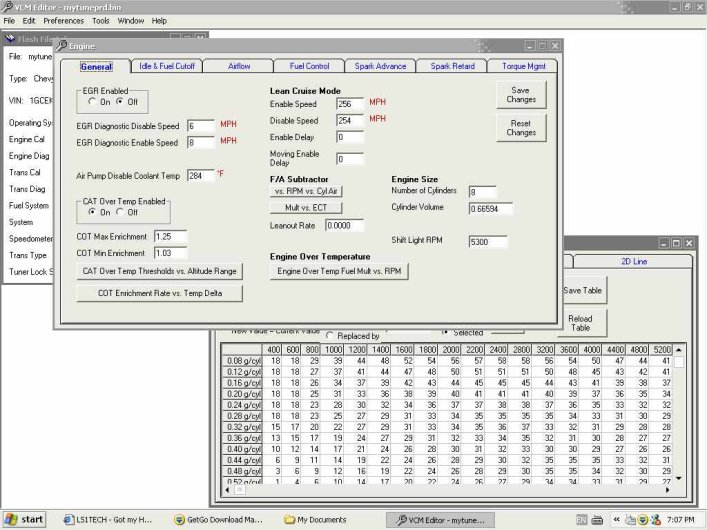

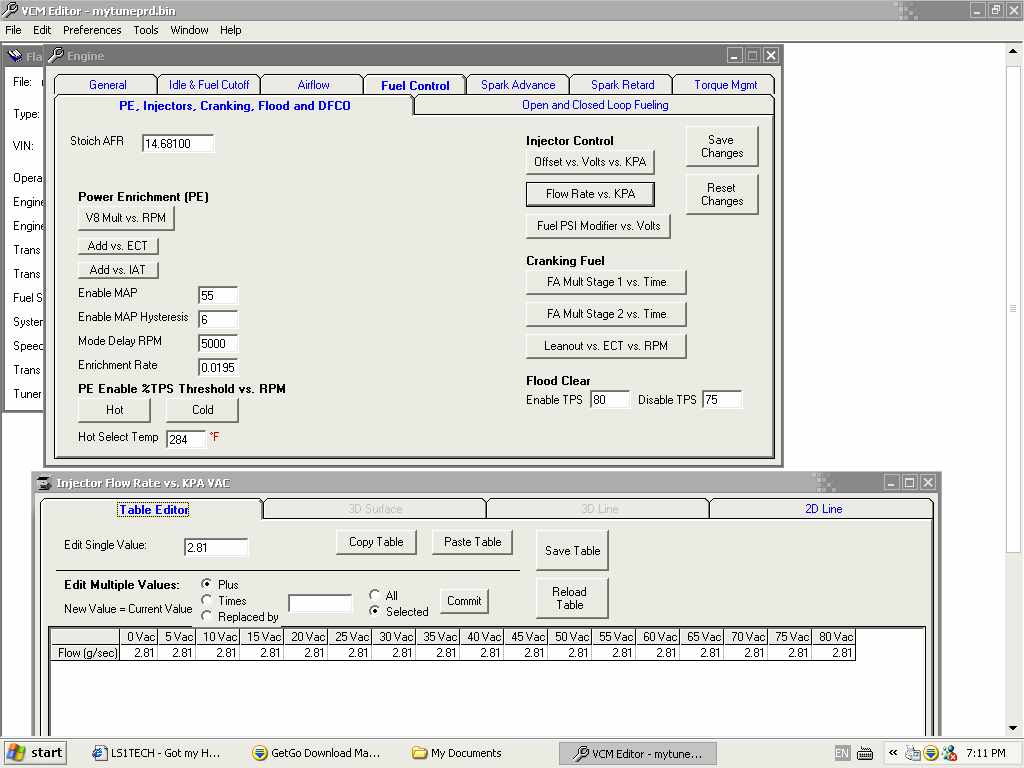

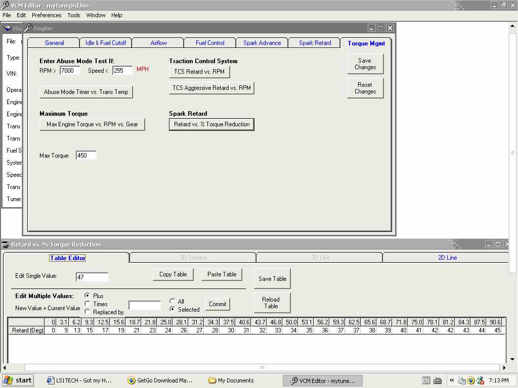

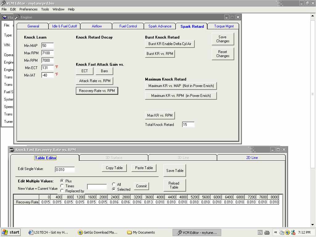

I can really feel a difference in power. The biggest change in power is from pulling PE, the O2 were way rich and it still is .930mv-.950mv and I know O2 aren't accurate.
Yes you can tune a supercharger, you can change everything you would ever need or want to change.
Attached Thumbnails Got my HPtuners today-scanner.jpg   Got my HPtuners today-scanner22.jpg   Got my HPtuners today-editer1.jpg   Got my HPtuners today-editer22.jpg   Got my HPtuners today-editer33.jpg

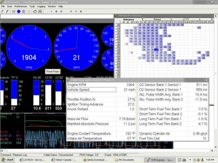

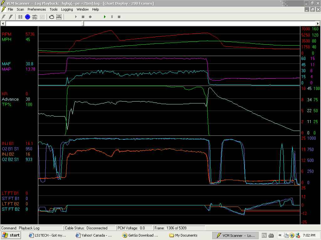

Here is a log file exported from the scanner. If you have a spreadsheet program, then right click and save target as.
log file
Attached Thumbnails Got my HPtuners today-editor44.jpg   Got my HPtuners today-editor5.jpg   Got my HPtuners today-editor6.jpg   Got my HPtuners today-editor7.jpg   Got my HPtuners today-editor8.jpg
I first tried setting all points in the low rpm misfire table to 32000, and it didn't work so I turned the code off.
