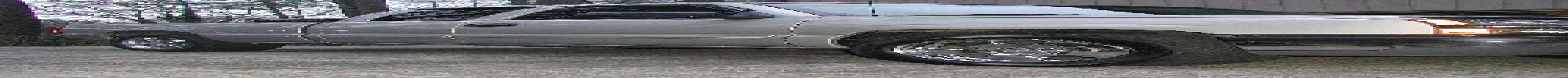

New at this. Have an 04 5.3L 2WD EXT CAB. Added a drop in K&N air filter and from the single stock exhaust I added a Magnaflow w/dual 2.5" pipes. I'd like to change the filter, exhaust and madebe add nos, I also used Hypertech for a tune and I'm good with that for now. Give me some ideals on what might be the best products or componets to get the best in performance for my money.
