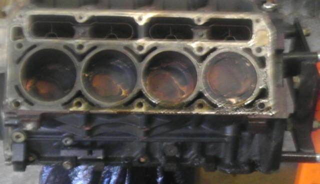

He sent me some pics I had to cancel meeting him today. I kno its not showing u much but thats all I got for now.

That is a Gen 3 LQ4 motor, 2004+ year.
Note the LS2 style lifter trays
Originally Posted by Zeke2007
Also see the LS2 style connecting rods and 24x crank reluctor wheel.

Yeah Zeke it does like the Good man above said look like an 04 - newer LQ4, looks pretty clean , I bet you will see crosshatching still in the bores , 100k ain't sheet on an LS engine as long as it was cared for.

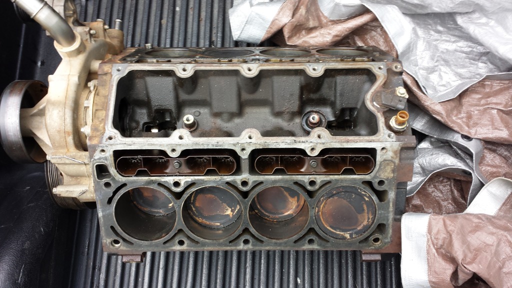

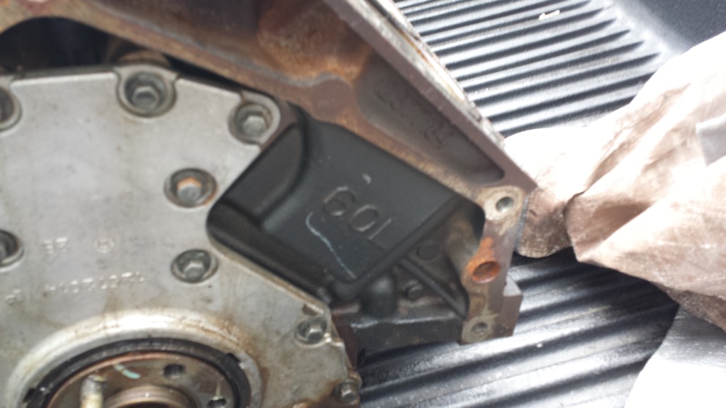

Picked it up today
Now I gotta save for more go fast parts. Once I start getting parts ill start a build threat an go from there. Heres a couple cleaner pics.

Nice!
Another way to tell its an 04+ motor is the low profile oil pressure sensor. The older ones are taller and have a different plug connection.

Is that what that is on the back of the block thats like yellow plastic?
Lol sorry I know nothing about these engines ima have to get a chilton book lol.

Yup. And the cam position sensor is right beside it. Hopefully she works good for you!
