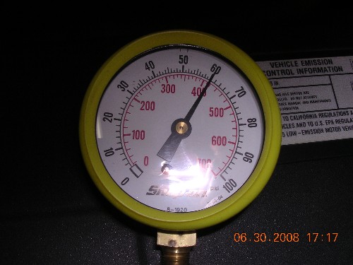

Here is what it should look like at Idle and then at idle with the vacum gauge pulled off.
Attached Thumbnails Fuel Pump problem again?-ls1-idle.jpg   Fuel Pump problem again?-ls1-no-vacum-fpr.jpg
