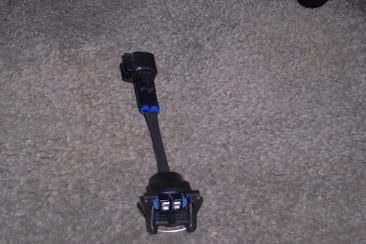

The Fords (which I bought to put in my 6L) are rated at 42#'s on a Ford fuel rail at 43.5psi. On a Chevy fuel rail they flow about 49#'s. I got adapters coming that clip into my injector clip and convert to the Ford injector clip but I paid $80 for them. You don't have to solder. Looks like this:
