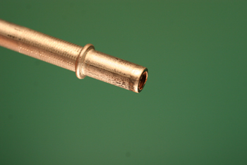

So you need some one to flare this ?

A cheap way unless you can have it flared at a shop or buy the fittings to make it work or buy the tool. Is to cut it and put a light flare in each of the cut ends, connect the 2 using a short piece of fuel injection hose and stainless clamps. Not the best way but would work, unless you have it brazed or welded back together after it has been cut to length.
