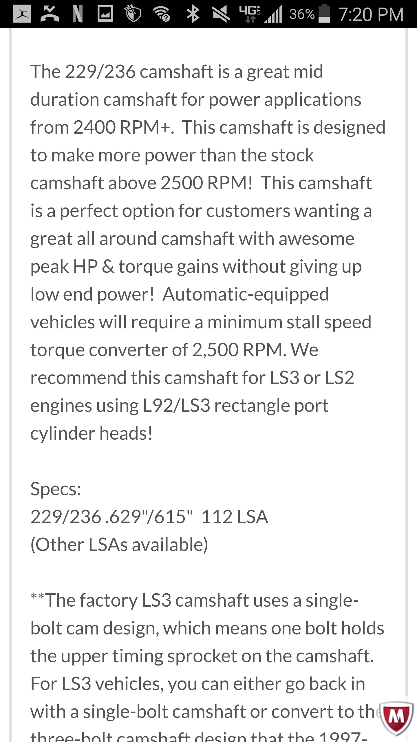

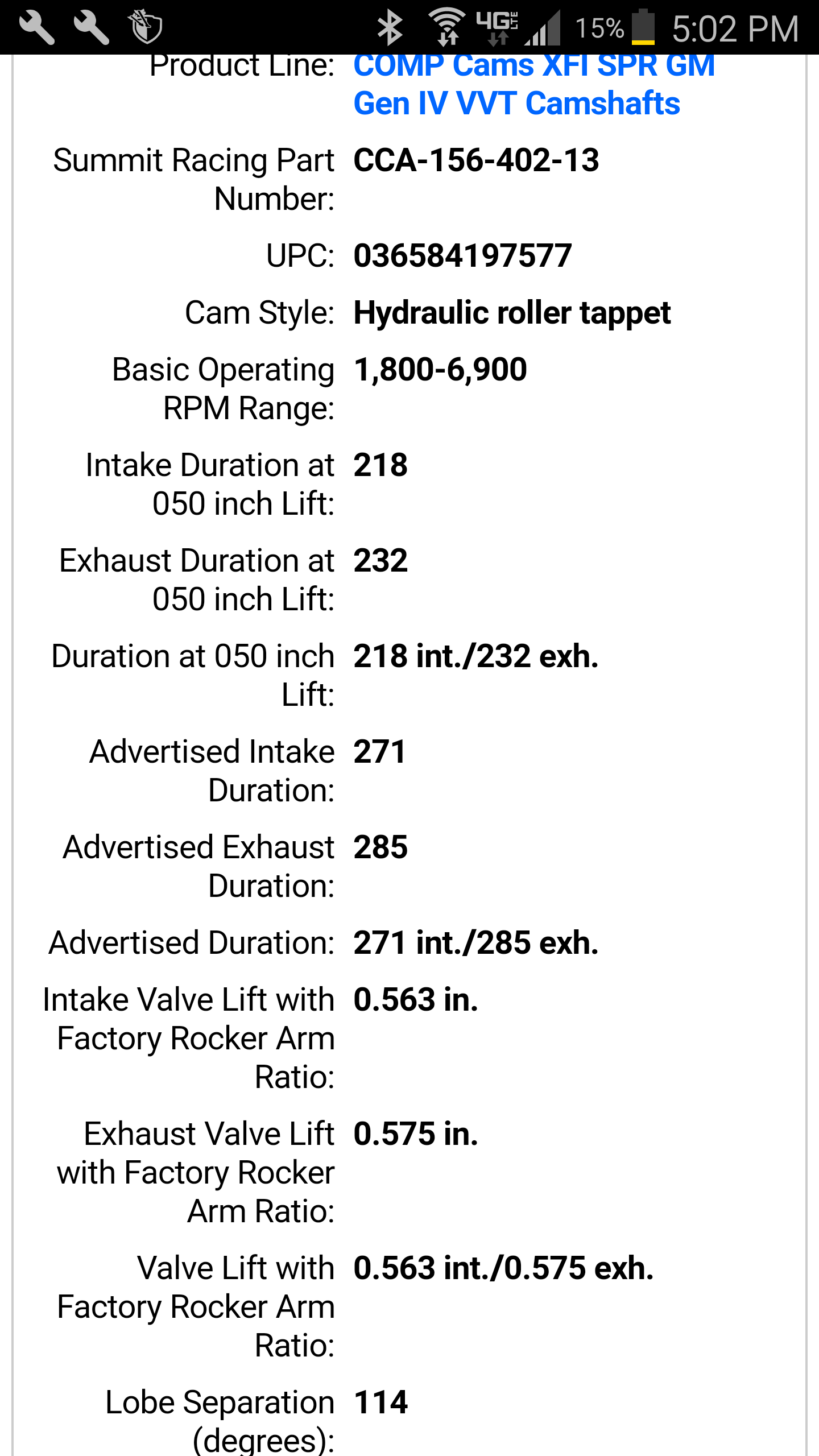

Now the questions, I am torn between the TSP stage 2 cam and the comp 402 cam for VVT. I want a nice lope at idle and I think the added lift of the TSP cam will be better if and when I stroke the engine. And maybe a better cam altogether? Not sure what spring to run. I hear pac springs and comp recomends a dual spring kit that is pretty expensive. Any reliable cheaper alternatives to the comps? With whatever springs, can I use my stock retainers or am I risking failure? Are ls3 valves better or just lighter? If they are better I don't mind buying them but I don't want to sacrifice durability. And is it just the intake valves that are better or exhaust too? And about the compression, I run only 91 octane. I can't forsee ever using 89. Can or should I shave my heads to boost compression or use a thinner head gasket or would that be begging for piston to valve clearance issues? I have posted this on a few forums but nobody seems to want to touch this post with a 10ft pole. Here is the basic info on the cams

Stock l92 rectangle port heads. I heard of the ls3 valves splitting and breaking before. But no proof. Btr sells a spring,lock, retainer kit. The retainers are choosy and lighter than stock. Cost is about 250$. Is that a good de as l for .660 lift springs? The lighter retainers make me nervous.
The pep springs i used are advertised as a .650 lift spring with steel retainers, i wanna say i paid either $150 or $170 shipped. Titanium retainers are lighter but are supposed to be stronger. As far as the heads there are 3 different castings, 5364, 0821 and 823, the earlier l92s were supposed to all have 5364's but i have seen all three on L92, L96 and L77(Caprice PPV engine) i have a set of 0821s that came off of an L96 6.0 that have the lighter valves, the 0821 were supposed to be exculsive to the ls3, but apparently they were randomly used on truck engines also.
The comp cam seems it would only be a small bump over stock, the other cam seems to be a bit more radical, but i am no cam expert by any stretch! I know there are two different cam actuators gm used and you have to have the roght cam for the actuator being an 07 you should have the 994 actuator, later models had, iirc, a 368 actuator. The part number will be stamped on the actuator itself. the main difference being in the amount if retard each can apply, something like 52 on the earlier and 42 on the later. The GPI vvt2trk cam i am running in my yukon spec wise is almost identical to the btr ls3stg2 cam in my silverado with a wider lsa and more advance ground in. Biggest thing with vvt is it brings power on much earlier and holds it longer.... your best bet would be to contact btr or some other cam company and have one specd, or there are a few memnbers on here that will spec a cam and can order it for you.

Thank you. I am buying a cam tomorrow. Btr, tsp, or comp. I will just see what is cheapest I guess. But I think the added lift of the tsp is best for my eventual stroker (anyone agree maybe?). I know it will be better than stock at every rpm so I guess I can't be upset no matter what. I'm just concerned because Justin at blackbear suggested the comp 402. Which makes me think it is better or he can tune it better, or unlikely, he hasn't any experiance with the TSP stage 2 cam I showed above
