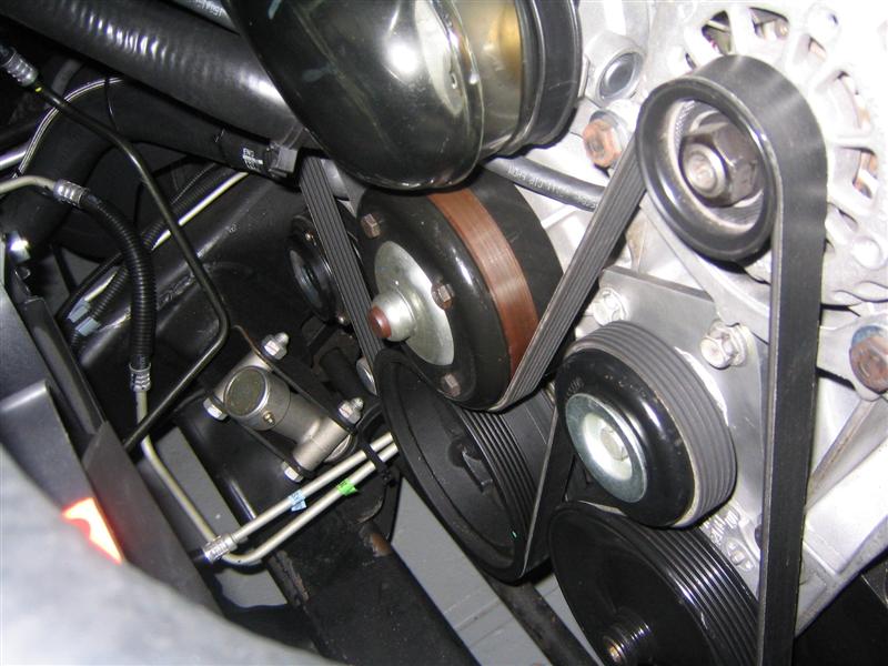

Has anyone got a pressed on pulley ....pressed off?
How do the WP remanufacturers do it???
Im looking at a car and truck WP side by side
everything is the same except the pulley, outlet
and one bolt hole for the tensioner

I know Evans can make you a high flow Fbody style front outlet pump with a truck spaced pulley on it. The Fbody pump needs to be spaced out a bit for the truck accessories from what I've heard so the belt rides on the flat pulley surface enough.
Depending on how you route the belt the front outlet can clear. It's been so long since I've looked at it I don't remember all the details though.

I dont remember who's pic this was but its the one Ive been going by

I think thats the Escalade that BigTex was working on. That idler pulley looks really familiar.
that Evans seems like a good idea
Im sure they got all the tools to do it right too
do you have a contact?
