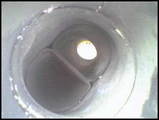

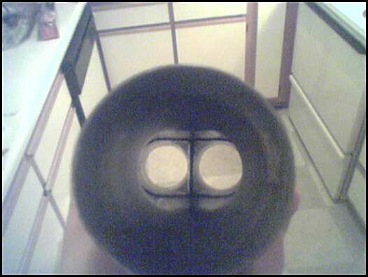

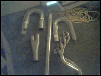

Decide to get off my *** today and finally went to weld up my y pipe with the flowmaster-y and u-bends I had. All I can say is wow. Even with the stock manifolds still on (thorleys are waiting till tomorrow) It feels as if I gained at least 15rwhp, noticable seat of the pants difference and throttle response just from y pipe and no cats!! below are some pics of the stock ypipe and the flowmaster
