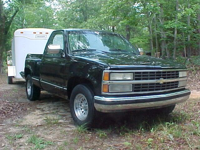

Below are a few pics of the truck I'm working on.
http://i191.photobucket.com/albums/z...g/MVC-004F.jpg
http://i191.photobucket.com/albums/z...g/MVC-003F.jpg
