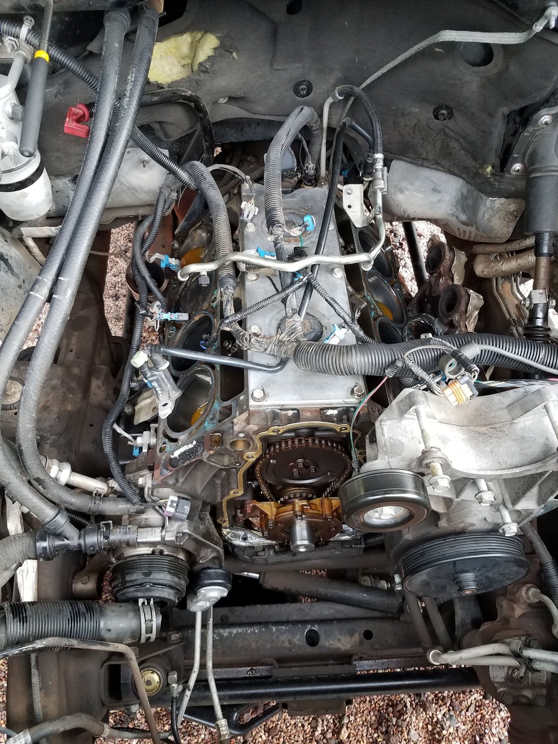

Well I tore it down today. Started at the flexplate with no luck. Tore the valve covers off, and everything felt good. Removed the pushrods, and they all looked good. But I found the intake valve tip on cylinder 7 to be worn down. So I preceded to remove the heads. Found intake lifter on cylinder 7 to be stuck about 1/16 of an inch lower than all of the others. It was definitely collapsed. After working it with a pushrod for a bit, I got it freed up. I disassemble the lifter and found a few black flakes of something inside of it. So I'm glad to say I found my problem. Going to pull the cam tomorrow. I'm too tired to go any further tonight.

Glad I tore it down. Camshaft was getting pretty bad on that lobe too. Caught it just in time I'd say.

Lol. Yeah it's really weird. I think maybe because the lifter collapsed where it did, that that's where it first made contact with the cam again or something. I almost didn't pull it honestly. I figured with that little of lifter damage, that the cam would be good. I'm glad I pulled it out.
