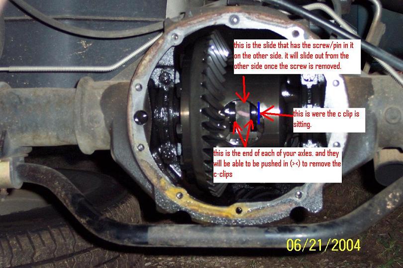

maybe this will help.

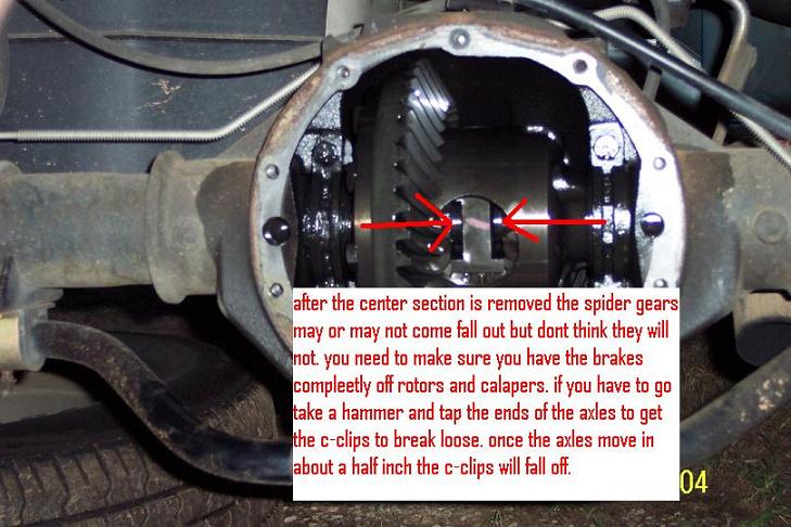

hear is another. i am gona have jokes about you changing a rearend when you finaly finish this.
you have not got to the fun part yet.

OK ... I've goten this far. The brakes are completely off. The bare axle hubs are showing, even the rotors are gone. I can push the axles in and see the clips. I can't get the damn things to come off though. That silver block in the middle seems to be in the way. I can't get it out, and I can't see how it would come out. I got the pin out and it will move around, but I can't get anything to come out.
I took a screwindriver after the clips to try and pry them off ... they didn't even budge! I think if I could at least get the differential out .. I could get it back in. The new one doesn't have all that added **** in the front of it.
On a side note ... I can see where some wtress has been put on that pin that goes through the middle. It has some nice scars on it. I see some hard dings on the gears too which tells me that they have seen a good bit of stress too, I'm guessing from the G80 being a little screwy with it's lockup and such.

i could help you more with a better pic of the other side. but tell me this the screw/pin came out on the other side (or the photo i did not wright on). if so the center piece will slide out from that side. on my buddies car i actualy had to take a hammert after the center piece because the rearend was trashed. i just taped on it to get it to slide out. i am prety sure it will not slide completely out just enough to let the axles slide in.
this sux when i have some good resources but none of them are in front of me.
get me a better pic and hopefully i can help some more.
