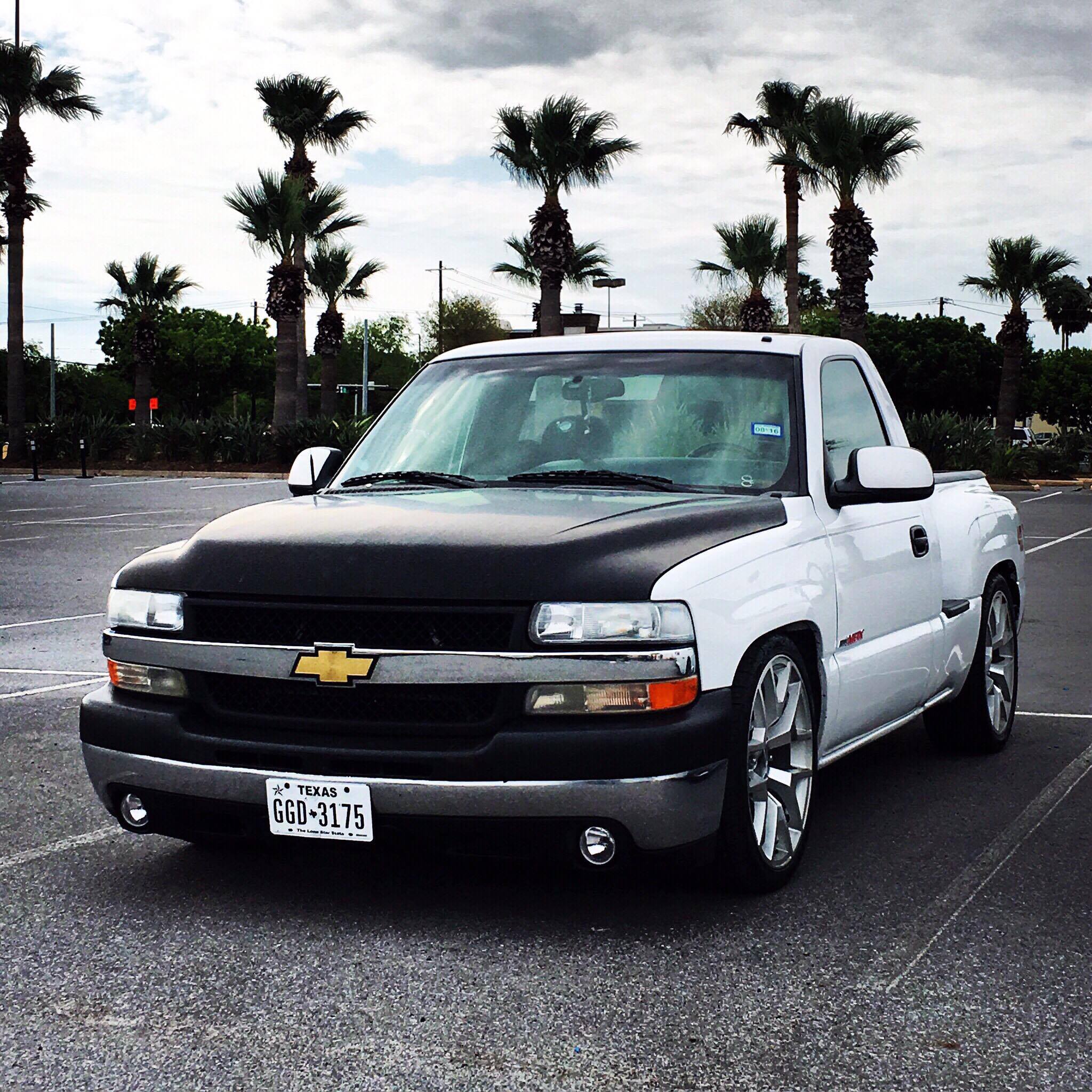

I'm sure this question has been asked a thousand times, but I'm new to the truck scene. I recently sold my C5 Vette to start / fund my pro-touring Camaro build.
I have purchased a 99 Silverado RC shortbed stepside and I would like to do a TRUE dual exhaust system. I'm buying TSP Stainless headers, cam and TBSS intake (on recommendation from a site member) and want to run a dual exhaust set-up. Probably looking to dump the exhaust right at the rear axle under the truck
Do any of you have this type of set-up and what mufflers do you recommend ?
Pic of new truck so you guys can see what I'm working with.
Thanks in advance for you comments and help.
