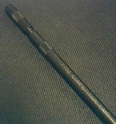

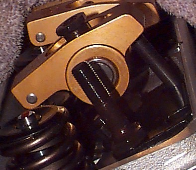

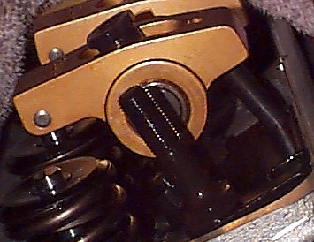

You should absolutely use a pushrod length checker. Optimal valve and rocker geometry is achieved when the travel of the roller across the tip of the valve stem is exactly in the center of the stem. This can be seen by applying ink to the rocker roller. Adjust the length checker, set the rocker, rotate the engine, check the mark. Repeat. Once you've found the right length you can count how many times the length checker has to be turned to its default position. That will tell you the length to order. Each pushrod length checker is different for the different manufactures. Order the length checker from the same manufacturer you intend to buy your pushrods from.

Well, this kind of stuff will depend on how much time you have. The pushrods themselves cost the same amount for the perfect length and a close-enough length, the difference is in the cost of the length checker and the extra 5 days you have to wait for it to ship to you.
Here's some eye-candy, I actually practice what I preach sometimes!
