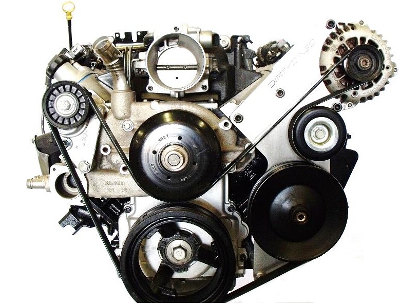

went to the dirty dingo website for a solution and found this bracket
as you can see there is just not enough contact area for the belt on the crank pulley, it might have some sliping with WOT pulls or or fast engine rev's
not to mention supercharger
so am I right thinking that way or not?

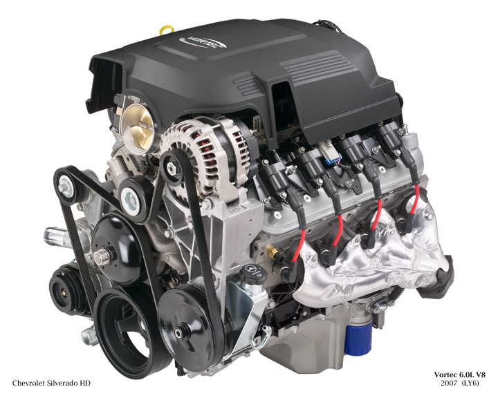

here is the stock bracket and you can see the contact area on the crank pulley
its like the dirty dingo is covering 25% and the OEM is covering 60-80% of the pulley

If your worried about hood clearance use the corvette acc drive. Pulley is $65, alt bracket is $75, a few other parts and it would be good to go. Total cost for the setup is about $250
