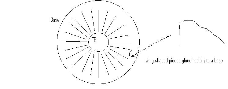

Why not just fabricate a base for a 14" air cleaner using the 90mm? That's what I have mocked up for mine...

I thought about that but I'm not convinced that's the best way to get air into a blade TB.

Old Oct 24, 2007 | 12:34 PM
SS_bnoon_SS's Avatar
Joined: Nov 2005
Posts: 655
From: West Des Moines, Iowa
I'll be making a fiberglass base for mine to smooth the air flow. I've got a bunch of "wing" shape pieces of wood cut out that I will make the mold out of. Quick scetch in paint of what I'm talking about doing...
