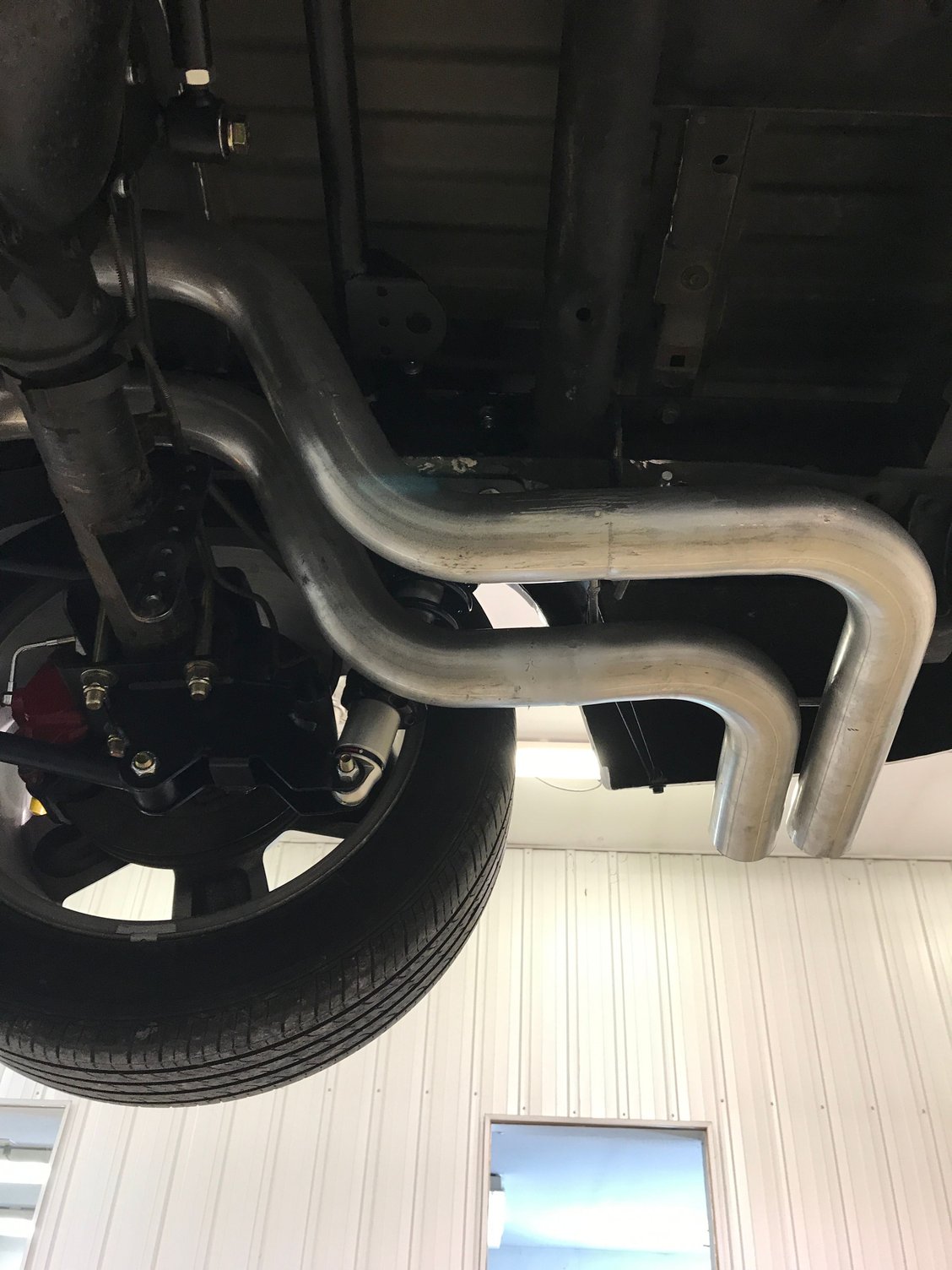

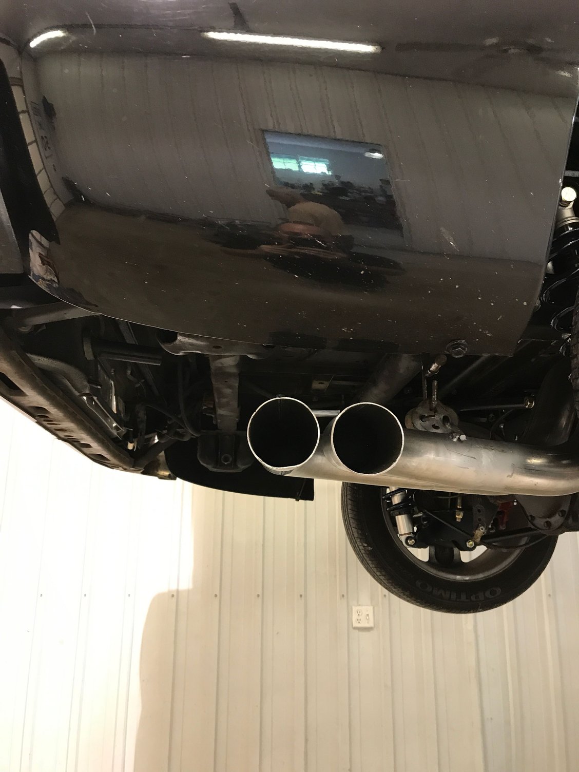

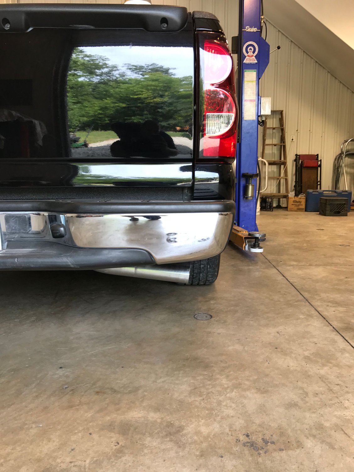

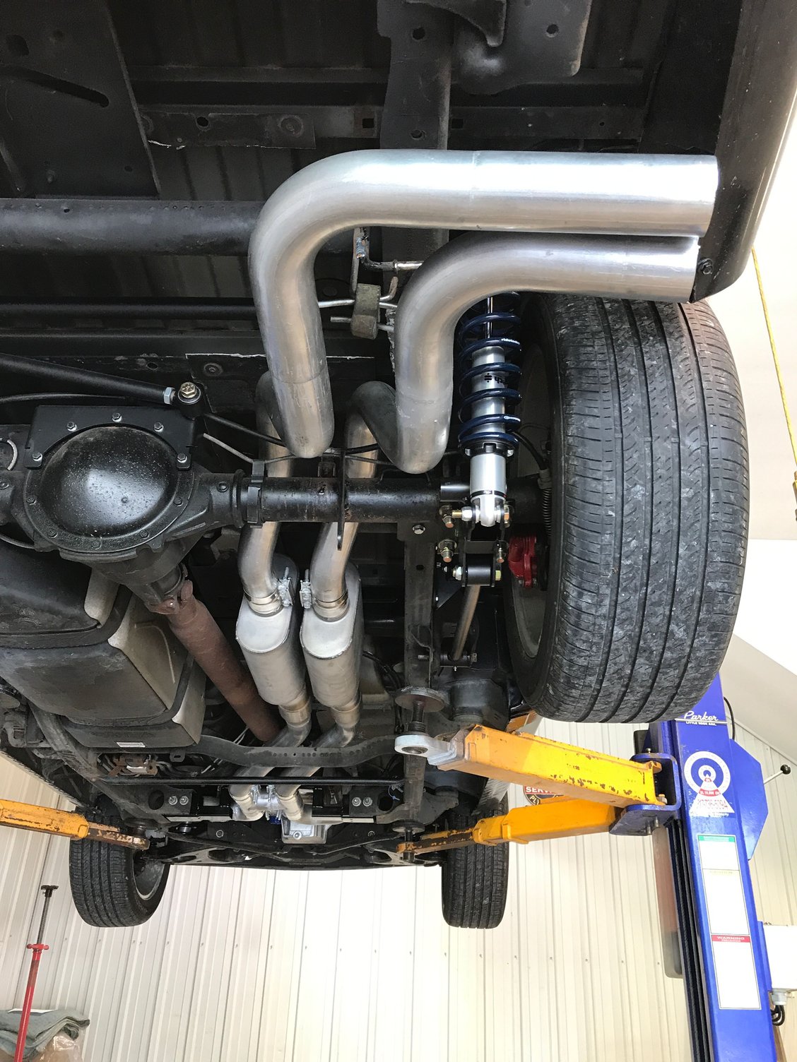

I'd love to build another one, if I had any time. With work and my sons hockey I barely have time to do anything. A lot of work, a lot of planning and a little time. It really wasn't to expensive in total I have around 400 not including the headers. It would be lees without high flow cats. I just added tail pipes, and it made a huge difference. Ever since I've had the truck ( and three different exhaust setups ) it has always been dumped under the bed before the axle. It has always had some drone and I have never been happy with the sound. I've ran a flowmaster a magnaflow and a pypes muffler before. This is by far the best sounding with no drone at any speed or rpm, just a nice deep rumble.

Wow, that looks great. Nicely done.

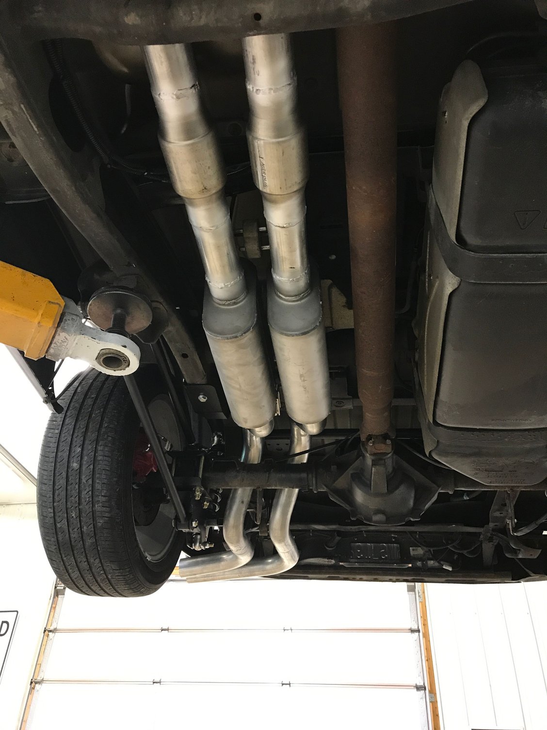

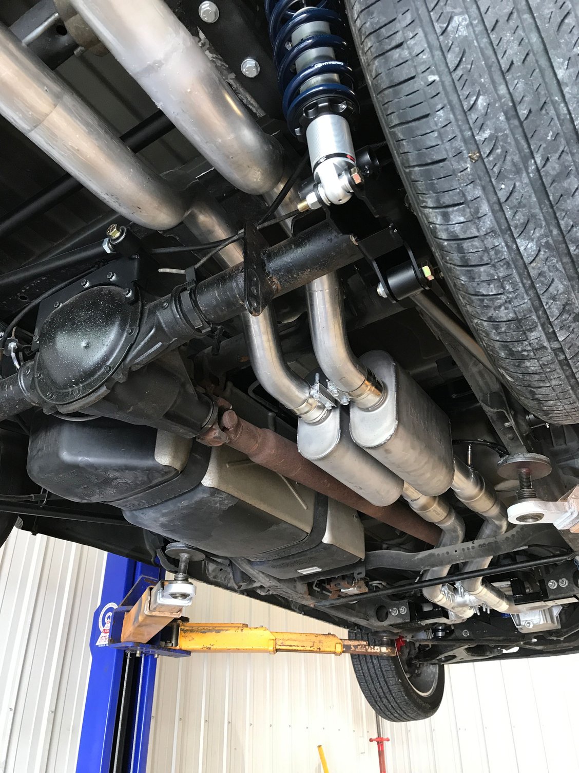

What mufflers and cats did you use? How big are the mufflers?

Mufflers are 14" Dynomax Ultra flos
Cats are high flows from AP performance

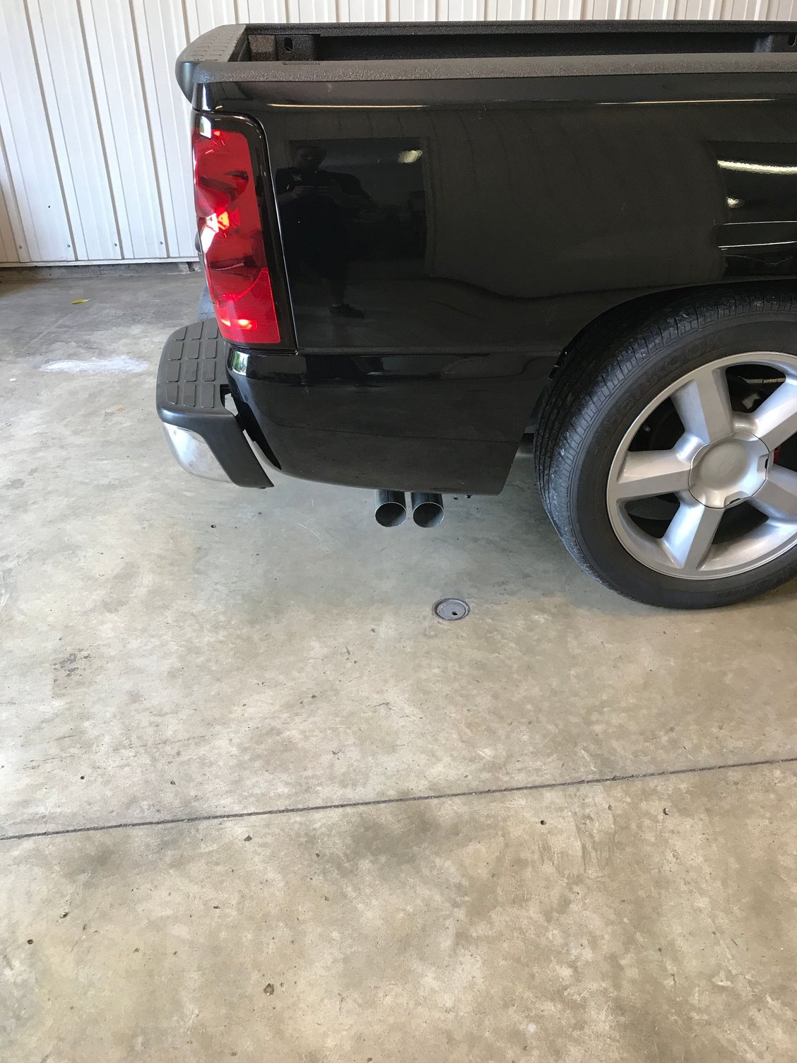

i wasnt sure sure about doing tailpipes, I never liked the look of pipes sticking out. I've always had dumps. I tried to keep them tucked up and in. The truck is low so you really don't even see them unless your down on the ground. Can't beat the sound with the tailpipes.
