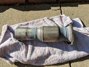

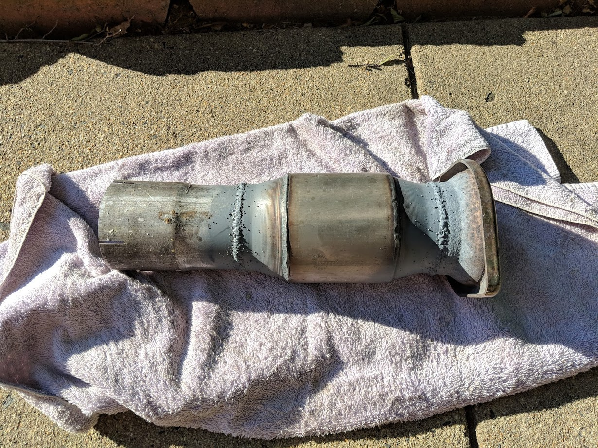

I can't speak to mufflers but I just installed a vibrant cat that muffled things quite a bit. They're compact too and easy to mount pretty much anywhere in the exhaust system. They're also rated to some great HP numbers. For me the final benefit was no more exhaust smells.
I did a quick and nasty job making mine mount right after the LT header Ypipe. I also added a slip fitting in case I ever decide to rebuild my exhaust in the future.
Yes, I know I can't weld....
