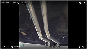

Originally Posted by 06 4.8
How low is it? I had true 3” duals ran over the axle on my 7” dear drop. Just had to remove that small heatshield below the bed
I have the same issue of going over the axle with my 4/6 drop. The Speed Engineering duals are not even close when installed. The section after the mufflers that loops over the axle is two pieces and the first section doesn't even have room.
Were your tailpipes mandrel bent or custom cut and tig welded to fit. I really don't want the pipes squished with a non mandrel pipe bender.
I have seriously considered having the tails run under the axle like this, but without the Corvette tips Don't see any clearance issues with a street truck but it does looks strange up on the lift
