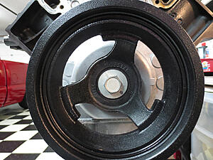

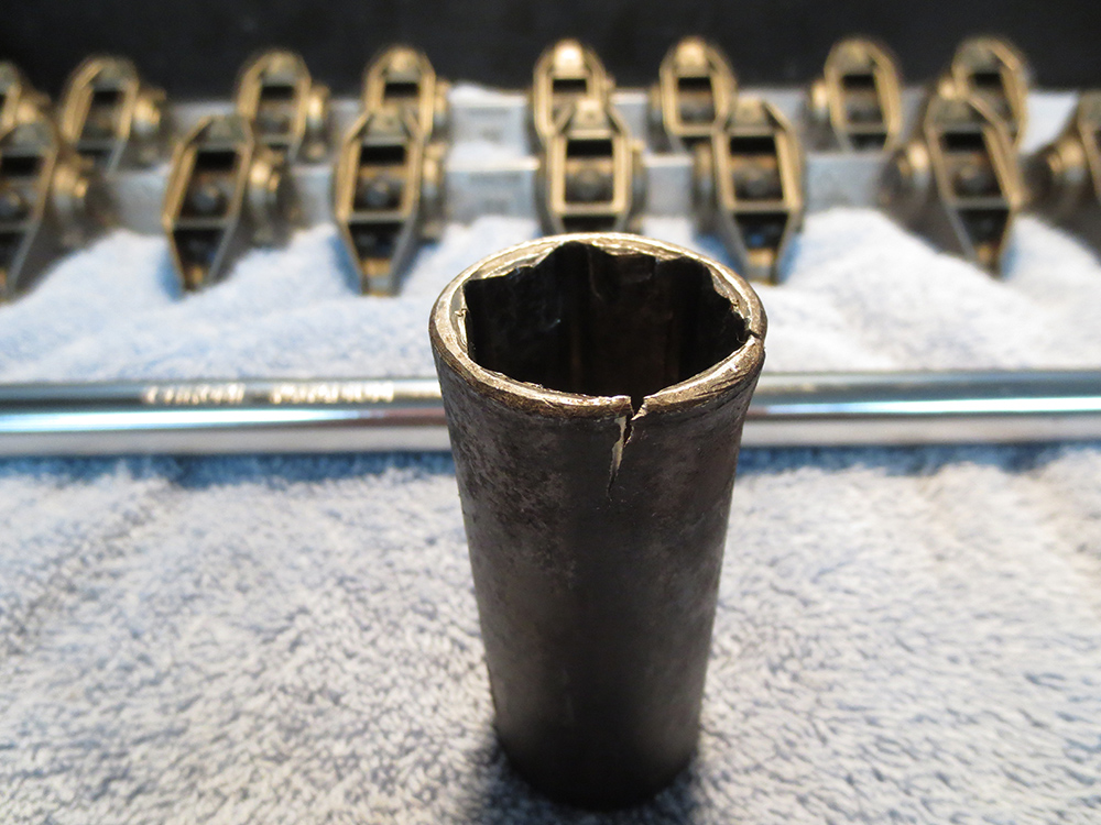

Yeah that 140* is tough. Used a 25" pullbar with a jack handle as a cheater got me close but the engine stand started to roll on it's casters. Pushed the engine/stand against the workbench, pulled up a chair, two feet on the engine stand frame, pulled hard... SNAP!
My heart skipped a couple beats thinking I'd snapped off the crank bolt! When I saw the broken impact socket (or what I thought was and impact socket) I could finally breath again!
See my mark... I'm calling it 140* anyway lol
