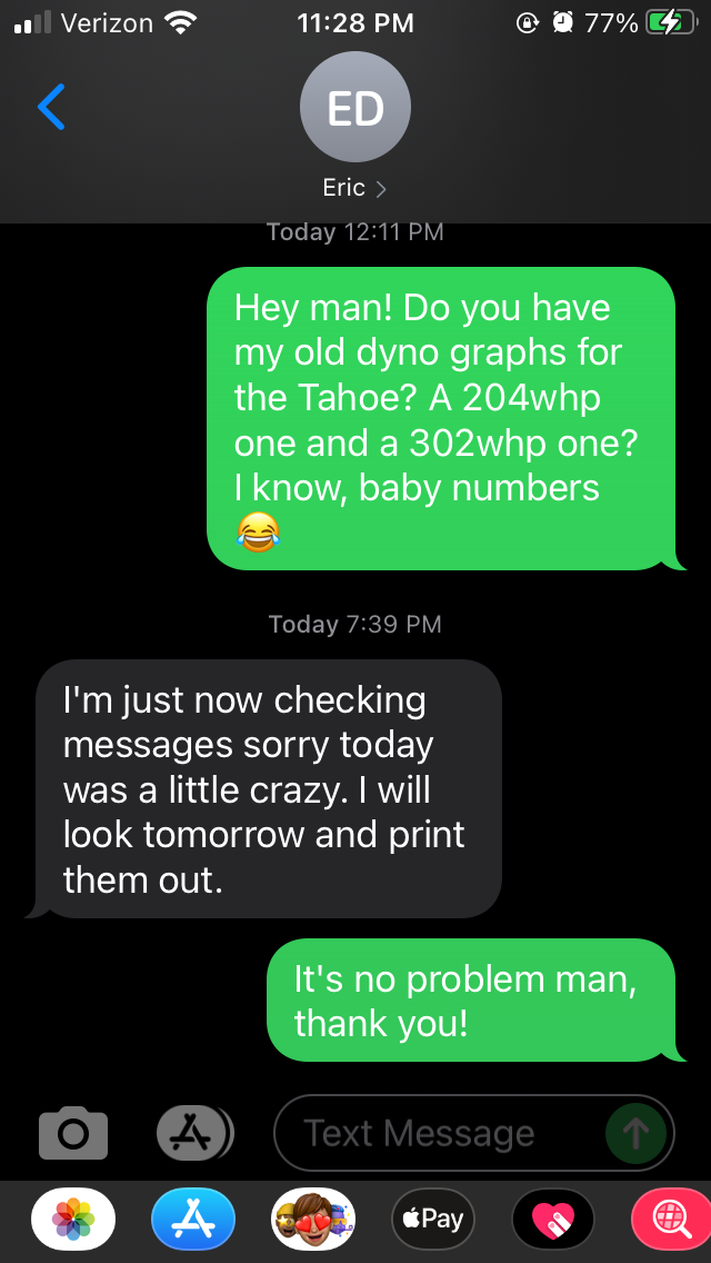

I'll reach out to my tuner and you can compare the stock vs modded graphs for yourself
it gained everywhere. I've proved you wrong on multiple occasions, so I'll be happy to do it again. Cam and LTs were the single best mods I did to my truck. And yes, I tow with it- almost 2000mi a year, and yes, it tows great

You're also the guy who plagiarized dyno graphs, so it's a little hard to give .5 ***** what you have to say or "think"
however, I will wait for my tuner to get back to me about my *actual* NA build (because if you follow me, you know my truck made 477 with 12psi at one point)
