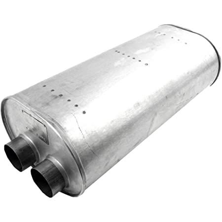

You ever get this finished. I'm looking to do something similar. Speed engineering long tube headers with dual 2.5" pipe to an X-pipe into the Flo-pro 2504 muffler I already have. It's dual 3" in and dual 2.5" out and is only about 10-15% louder than stock.

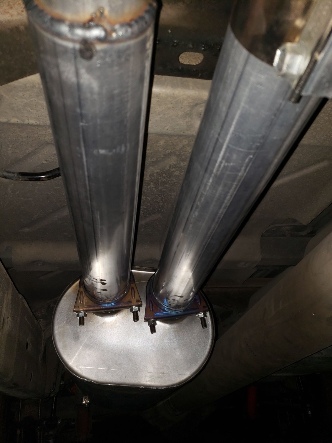

My preliminary measurements - It looked like where I want to cut the cat's collector off, I SHOULD have a ton of wiggle room to make it all fit. I have an x pipe, 4' straight pipes, and 5' straight pipes, and a couple S pipes that are for the tail, but I could use as intermediate pipes to fix an angle if needed. I might have to use one flex pipe, and I can always cut and twist the "second cat pipe" that will come from the driver's side. The only tight space is at the trans crossmember, and that shouldn't be a problem at all. There is plenty of room to mount intermediate pipes and any size muffler.
I started out wanting to use an X-pipe right in place of the collector. I changed what muffler I wanted to use when I first had that plan, and the new muffler is an x pipe design. I plan to get the scavenging a little farther back. I know speed engineering has their own X-pipe that fits those headers. I would contact them, and see what center to center is on their x pipe down stream, and see if it measures equally to your muffler. I know on there system, they are running straight pipes from their x-pipe to their dual mufflers. Even if it doesn't fit, you SHOULD be able to get two straight tubes (they sell the tubes you would need). Even if it doesn't fit perfect to your muffler, you can cut one pipe down (can rent a tube cutter and a pipe expander if you aren't welding it at autozone rent a tool for about $80 refundable), and use a flex pipe to get a little flexibility in the tubing.

So anyways, I have tried every lap band clamp I could find on Summit, ebay, and amazon. None of them were made well or fit right for my pipes. I have plans to eventually do Atomic's coilover, and I talked myself into doing the custom tailgate I have wanted for a while, so I just bought my first welder. I have to piece together the accessories, and learn how to use it, but I think with how I am doing this, welding is just the only option. I could have just taken it almost anywhere and had them do it, but where is the fun in that?
